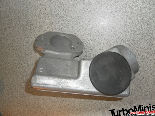

I need some advice, somebody offered me a plenum, but I never saw this one before, can you help me out from which car it is and if it is usable for a Mini.

This is a plenum of a non-turbo Montego or Maestro. It's not suitable for use on a turbo engine as a direct replacement for the Metro type one.
It could be made to work, but it's lots of effort for no gain.

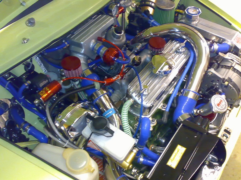

Ok, thanks for the info, in the meantime I found this picture, it looks like the same plenum used on a turbo engine, but modified:
http://3.bp.blogspot.com/_NQx9JW1cMv8/TSEW...00/399716-1.jpg
Very clean engine bay though *Clapping*
Thats richards engine bay on his van.
Search turbominivanman hes a very helpfull chap. Im sure it will be in his build thread
Edited by cossierick on 16th Oct, 2012.

Thanks cossierick, I pm'ed him, that is a beautiful car, wauw.
turbominivanman
1105 Posts
Member #: 1504
Westbury, Wiltshire
Yep. It's my engine bay.
Have pm'd you Rene.
Basically, i did the mods that Wil talked about above but due to fuelling issues and hours of work trying this type of plenum to I eventually took this plenum off as it just wouldn't give me the right increase in pressure I needed in the float bowl to overcome lean-off, even with the necessary 37mm diameter restrictor plate between the carb and plenum.
It would work well on a Normally Aspirated engine but I wouldn't recommend this type of plenum for turbo use.
Richard.
