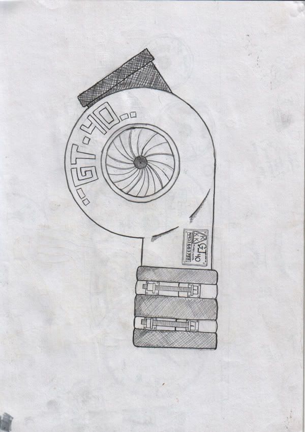

someone can put a sketch or drawing?
Haha smart ass
gttalpine
53 Posts
Member #: 9238
I mean like putting water pipes turbo, I have and I have bolque drilling the thermostat cover underground but not as plugging (sorry but I use google translator and Spanish here is very difficult to find information
