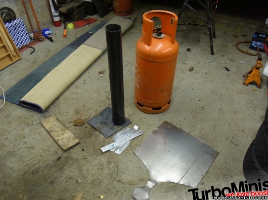

Started with this:

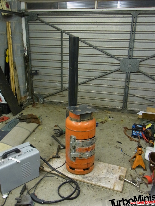

Then did some cutting:
Then some shocking welding later:
The plate is so I can put a pan or griddle on it.
Quality. love it.

It's for the garden, not the garage. Garage stays nice and warm as it's integral.
Problem I have is that the garden is North facing, so as soon ast the sun goes down the garden is freezing, this should take the chill off.
I have plans to add adjusttable vents and a seal round the door, but for now the venting system is the door.
Was debating the idea of a grill, I'll see what I can bodge up.

Looks good, Wil, but that welding is shocking. I might have to confiscate the welder when I am up this weekend.

If it was on a car, I'd have stopped and asked the internet where I was going wrong, just not good enough, but for this I couldn't give a shit.
