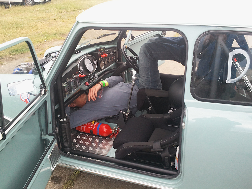

This is how mine is setup with a lot of help from Andy, Brett, Robert at Avon / MITP and it worked well on the road and track, I had the Actuator on around 10psi then on bleed it was 18psi.
But make sure you can not get to that Bleed valve when you are driving *happy*
Simon.

Hahaha that was a funny day.
It was surprisingly comfortable.
t@z
2054 Posts
Member #: 452
Chester, UK
if you haven't been in that position in your mini then your not fully committed :) seriously the worst/awkward/uncomfortable ever
www.twitter.com/lilpinkiy
well i had a Andy to do it for me, also that gear linkage is just a pain in the ass.
