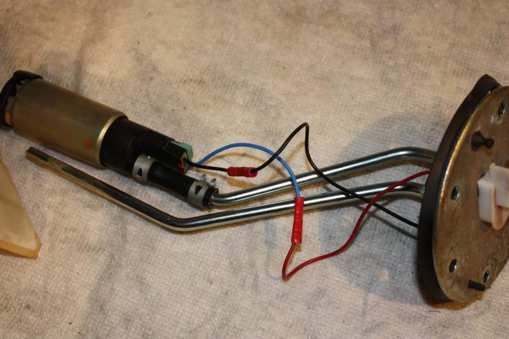

Ages ago, when I was building a turbo Mini, I did some reaserch and decided on buying a high pressure fuel pump from a different make of car (can't remember what car!).

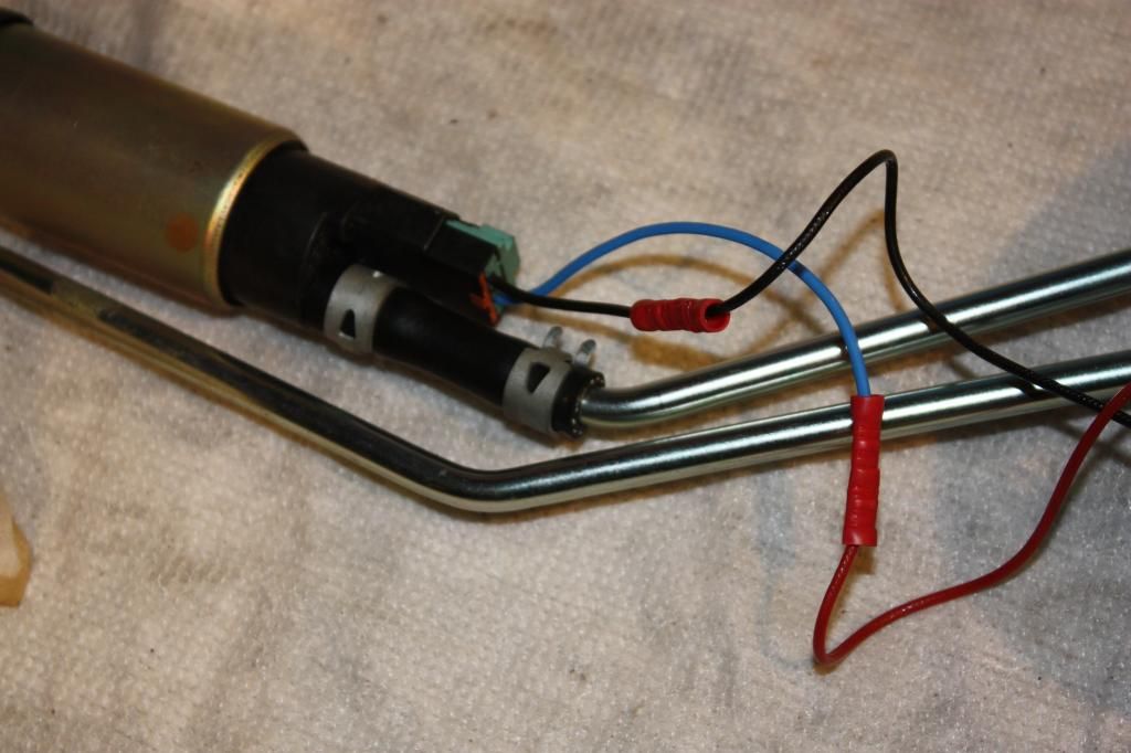

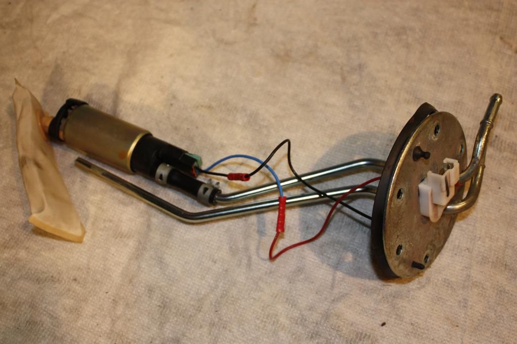

I have today tried to fit it and just wanted to check whether I have done something really stupid or something safe. I have cut the old wires and crimped the new connection on. Is this safe:

I would have put some shrink wrap on it as you have petrol in contact with the elastictrickery.

I would of soldered the wires together then heat shrink it as andy suggested

As long as the crimp is sound, it is fine.
