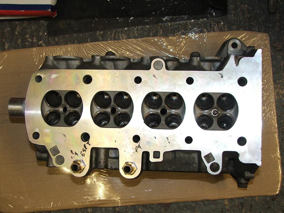

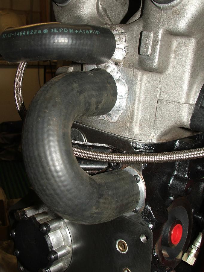

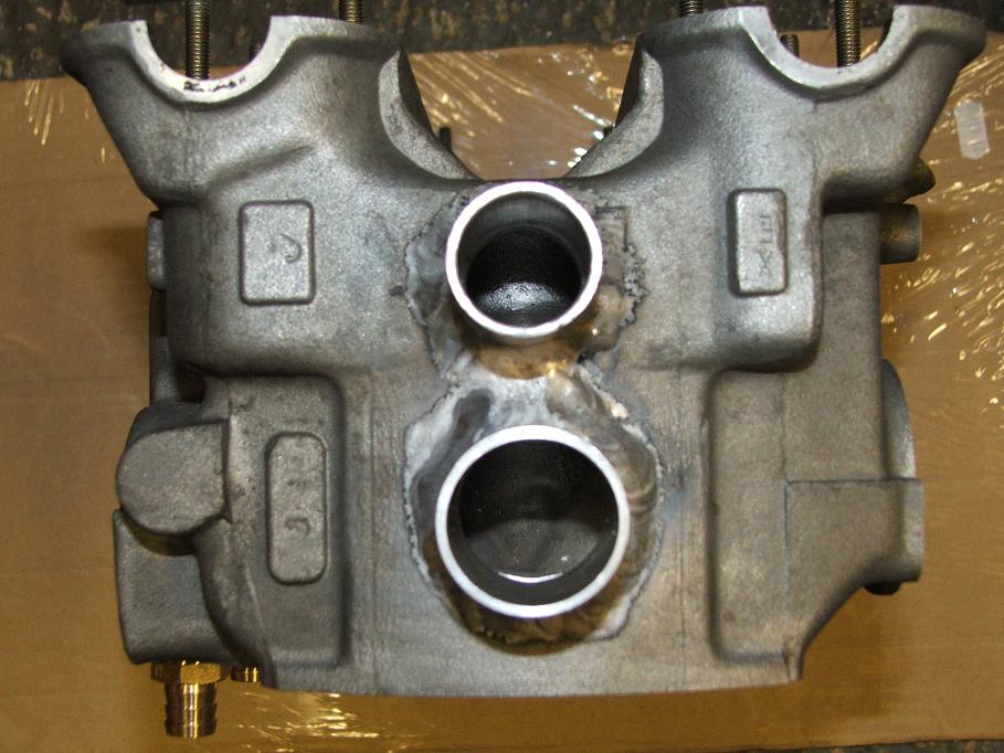

Hope these help give you a better idea.
Word of wraning, take your time re drilling the new stud holes. They will wander where they intersect with the old holes that have been plugged
Note that the welding doesn't need to be perfect so long as it doesn't leak. Remember that you are now simply sealing the cylinders with the gasket and that the gasket need serve no other purpose than that. That said, if you are doing it for some one else, it is probibly in your interest to get it as perfect as possible, even though it won't really matter. You can see one or two areas on the head face in the picture below that were a little lower than the rest after a skim.
