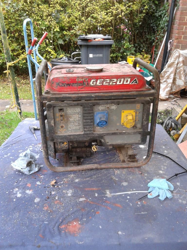

heres a pic of the bad boy.
yup , i think a compressor was aking a bit much simon ,can you swap the 110 breaker into the 240 side , is it the same bit of kit ?
yes it looks the same, i will have to get the part nub and see how much they would cost for a new one.
well i have just had a better look and there both have the same part number AC250, K76 also has 3J13 on there.
