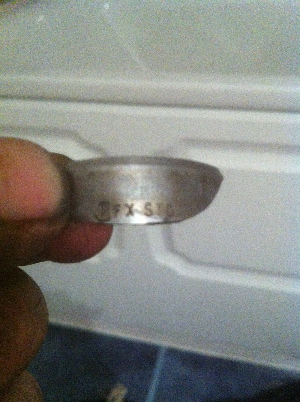

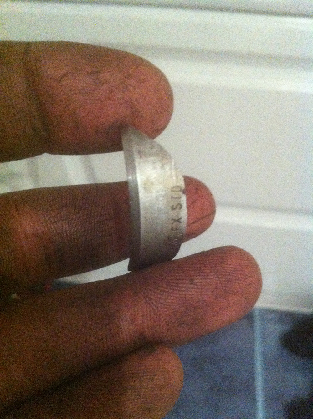

Hi all need some help. Drained the gt engine oil tonight and found the lump of metal in the photo. It is bearing material as far as I can tell and looks to be the same circumference as the end of the camshaft, oil pump end. Any ideas other than mine. Many thanks Adam.
Fucking hell, now that's some shrapnel!
looks like a (BIG) bit of cam bearing!
My thoughts too. Certainly a bearing anyway
6966 Posts
cam bearing is the only one with the kind of chamfer that i can think of
Shit the bed!
yes i must agree, cam bearing ........... you must have been trying !
what brings to mind is wank oil thin snake oil like, 5/10 grade or less ? in the engine or oil which has never been change for manyyyyy!!! miles.
also incorrect installed cam bearings and or oil pump failed as the cause of the above...................

Hold on a minute, it can't ber cam bearing as you cant get oversize that i know of, and that says standard,
anyone heard of oversize cam bearings?
carl
Don't they all have std on them? Cambearings that is.
4309 Posts
Yep, my spare AE cam bearings are stamped with std on them

probably diddnt happen when the car was running. maybe fell in the gearbox when someone was doing a job on it? there are clumsy people about
what does the concave side look like?

Id say yes you can. Oversize in terms of the actual hole they go into, not camshaft journal size.
Either way, it would be advisable to take that engine apart immediately lol

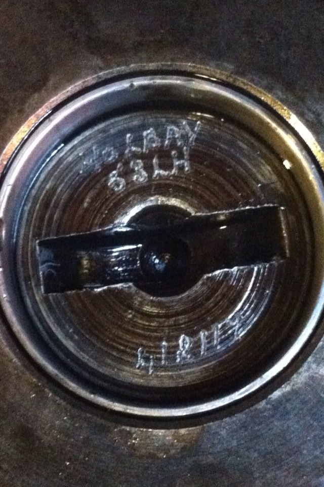

Hi, I'm lee(Adams brother) i brought the 1275gt!! We have taken the engine out and found out the pistons were +40's. now taken the clutch off and the oil pump to find the cam shaft is a holbay 53LH. Has anybody come across these before?? Thanks lee.

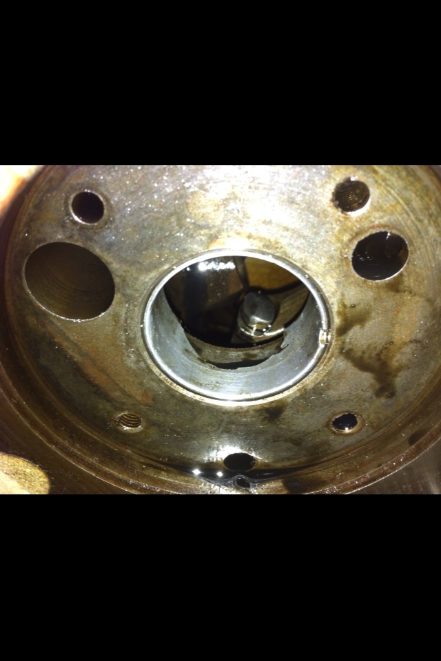

did you notice anything missing from any of the camshaft bearings?

This is the cam bearing, oil pump end.

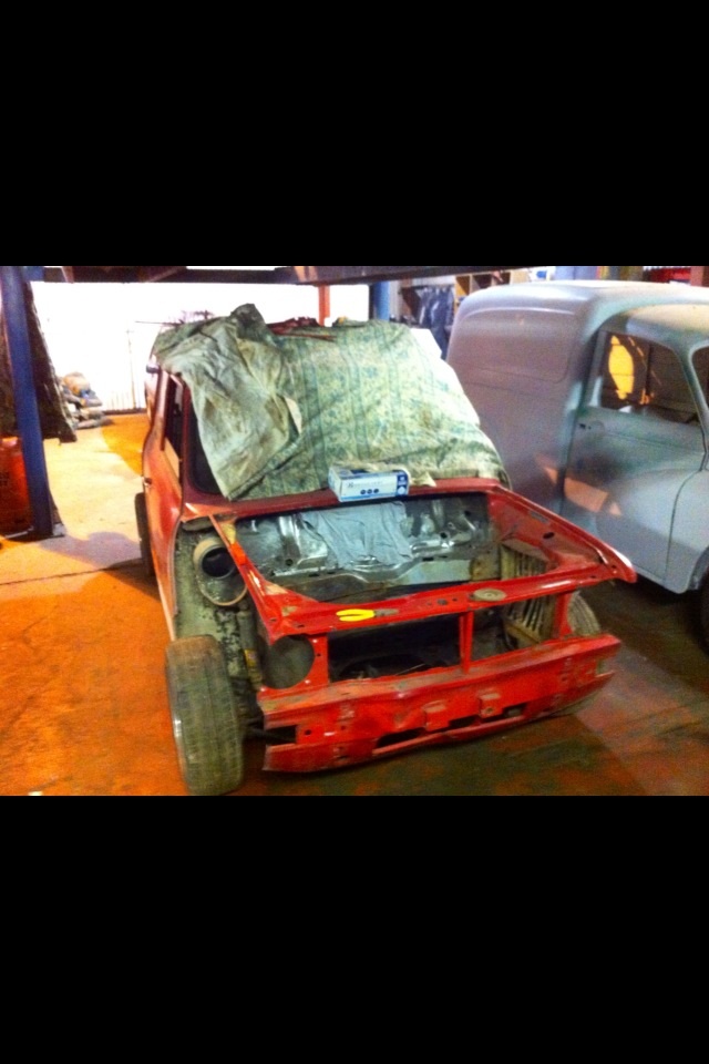

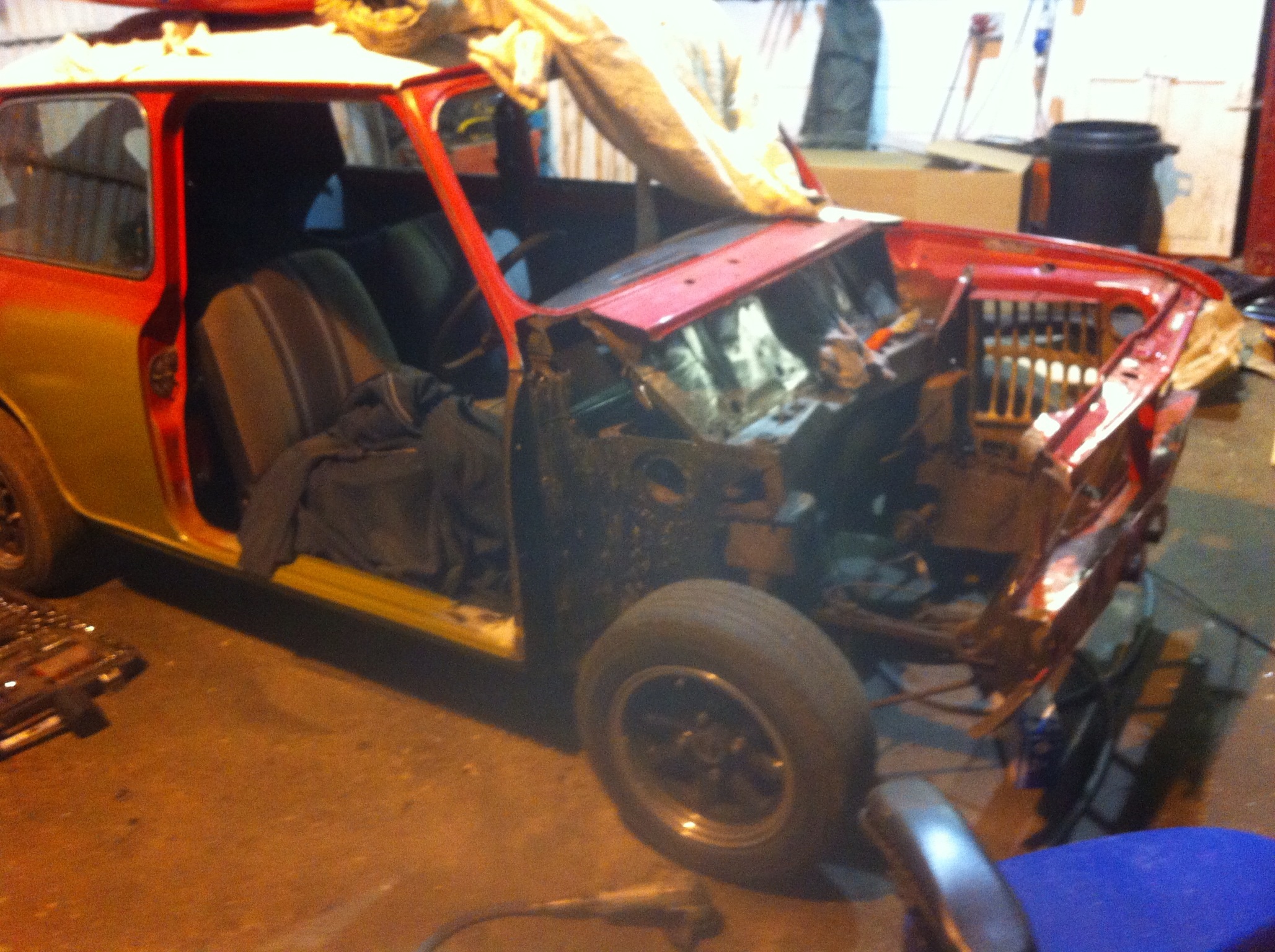

Ok so the first picture is the writing on the end of the cam. The second is the clubman getting ready for a whole new front end i.e inner wings, outer wings, "A" panels, front panels. Lots of work to be done!!

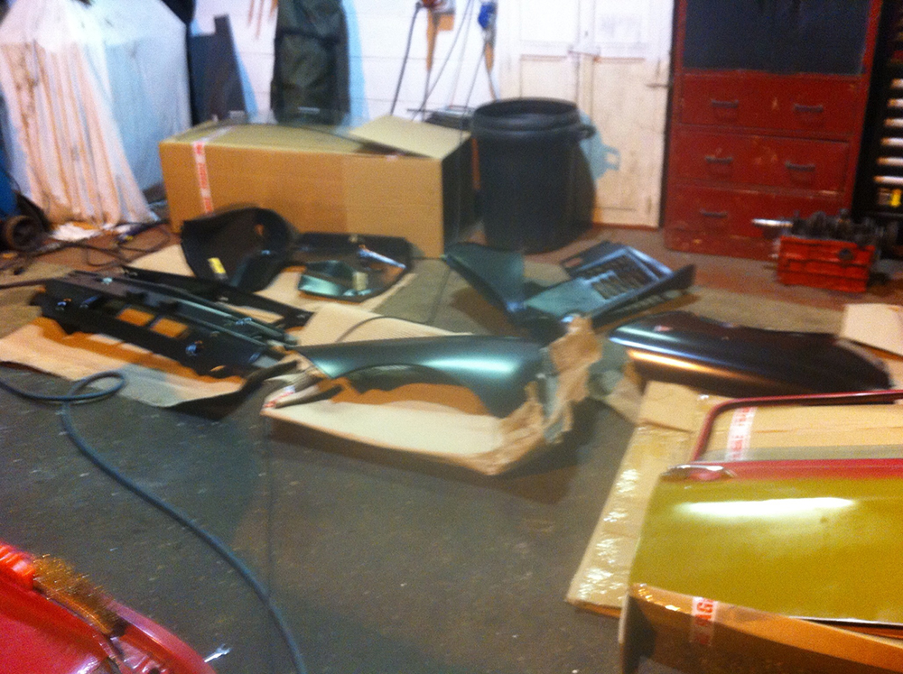

Yeah I couldn't really believe it either:( well anyway here's some more photos, hoping to get a bit done over Christmas.here we have all my lovely new heritage panels, kindly delivered very quickly by Somerford mini. And the progress today, just cutting out ready to grind down the seams and start repairing/ fitting new panels:)
