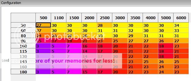

Craigh can you post a pic of your megajolt map for us?

Heres the map
stevieturbo
3597 Posts
Member #: 655
Northern Ireland
Even 12/13 during normal off boost driving is quite rich. You should be looking to see high 13's at least for normal driving.
