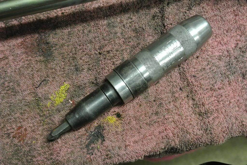

Use an impact screw driver, works for me.. Alan

That would work for Cooper S type which use a countersunk screw, but the 8.4" type use a hex head bolt, which is usually a LOT tighter than the countersunk screws ever are, as the wheel studs are on the disc of a Cooper S disc, meaning the wheel nuts clamp it all up, but on the drive flange of an 8.4", which means the 4 bolts have to transfer all the braking load.

ok Tom I got it wrong I was thinking it was cooper s disks.. Alan
