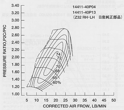

I was wondering weather anyone had used one of these before or weather this would be a good turbo to use for a 998T?
No idea. If you can find a bit more info we could have a guess.
Things that would be useful, compressor map, A/R ratios

I have done a search on the net and found a map and some chat on the 300zx forum and some info about the turbo's:
''tb22 .63/.48 which is basically a factory t2/t25 hybrid''.

This may help
http://www.ztechz.net/id1.html
That's too big for a 998, you'll struggle to make any boost.
