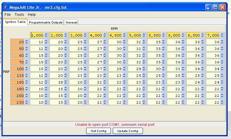

this is the map ive got on mine at the omoent
its from a trurbo mr2 running 8:1cr and upto 16psi of boost
but i havent really tried it yet just burbled up the road

Hi Grey. Don't see any map...
1967 Cooper 's' Turbo build @ www.drjing.com
ah balls, i think it must be saved in the format used by the ecu
