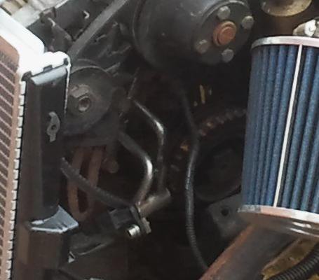

You don't have a picture of your VR bracket do you?
ill have a dig about, if you pm tom fenton he may still have some, he supplies some mint stainless ones
there we go best i have on file
Cheers Brett, been using the search button and saw these but the post was years ago. :$
I'll drop Tom a PM and see what he's got, picking all MJ bits up today but think the trigger wheel is a weld on one so may need machined bottom pulley like in old posts by Tom.

if you get a TomF bracket it wont work with a weld on 36-1 ring
Pm'd Tom to see if he has both, 36-1 pulley and VR bracket.

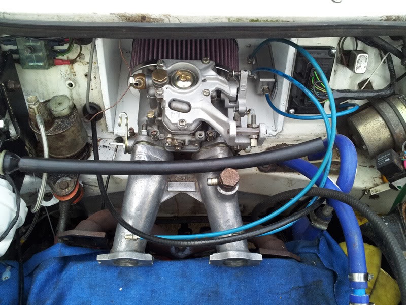

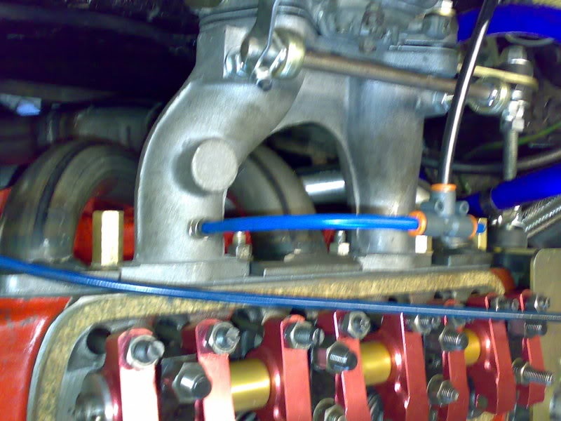

My only question now is as I'm running a 45 weber with no take off for the MAP, I know I need to run vacuum tubes fron both inlets are these ok to just be T'd together before he MJ or do they have to go to a small chamber to create a sort of mini manifold.
I have read of both ways but no one has said if either one is better.

Hi there Mate, I had run my weber with a TPS, as for a base map, I just loaded the 1380ccMAP, map that was on the disk you get with the MJ, then I drove to minispeed under 40mph all the way JOB DONE!
The advice on the autosport labs website if using map would be to put an inline box to help equal out the signal. A bloke in our local club used a small plastic fuel filter as it was about the correct size. His engine did work well but then he was a flat out or nothing kind of driver.
Good luck, once you go mj and get it mapped you won't go back
Mini only really built for runs and of course MITP so not used daily.
Think I'll go for the box method and hide it behind the dash with MJ.

Hi all, it seems that there are mixing feelings on weather to go TPS OR MAP.
Done plenty of research on autosportslabs and forums and decided to go for MAP, I've now converted my MJ to MAP. nice and easy job just remove R3 from the TPS section and fit the MAP / capacitors and resister to the MAP section.
If I do experience issues can always revert back if required, but thinking of building a turbo next and to be honest I don't think the BP270 cam should cause much issues as going to fit a 80cc chamber too dampen the signal.
Going to copy my current dizzy advance curve to be on the save side, before it goes to the rolling road to be mapped properly. I know this will only be 2D (no vacuum used) but should get me going.
Can always drop maps in and try but think this is best done on RR, keep you posted on progress.
