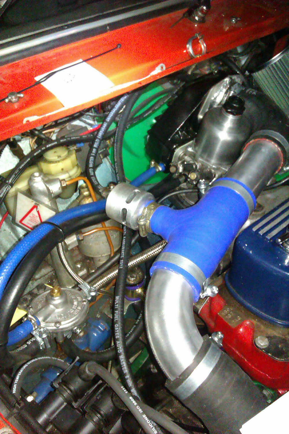

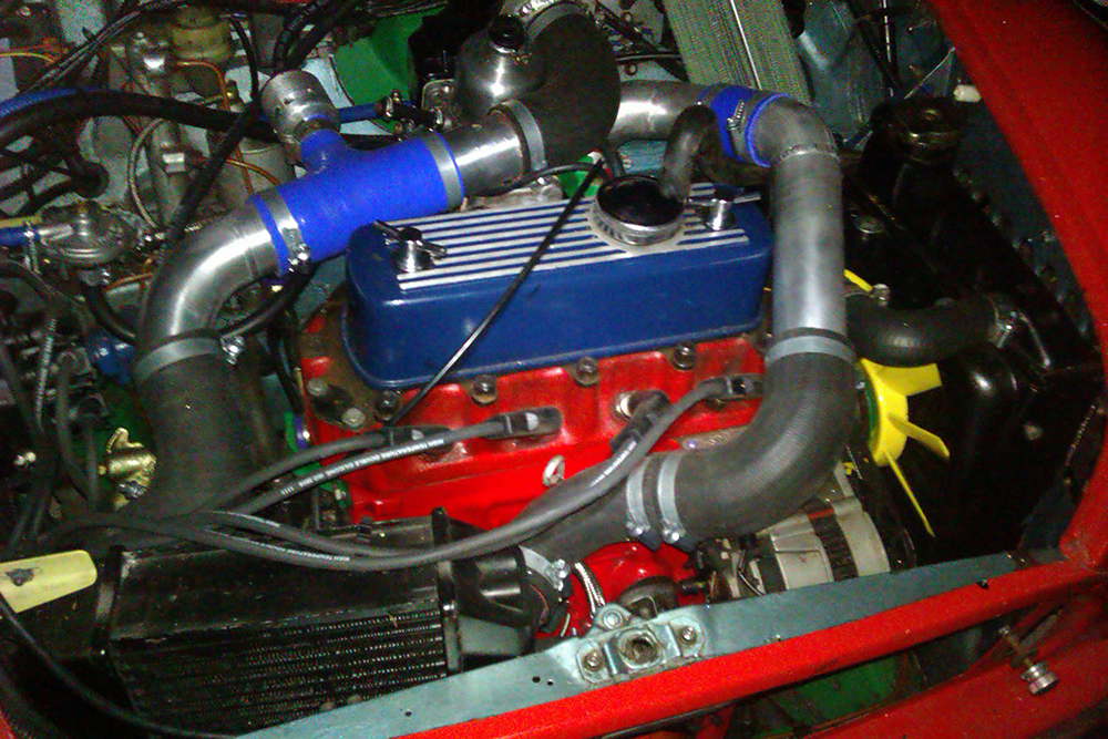

ok. will pick some more up andy. cheers. here is a couple of pics just in case someone can spot if i have ballsed up somewhere.
