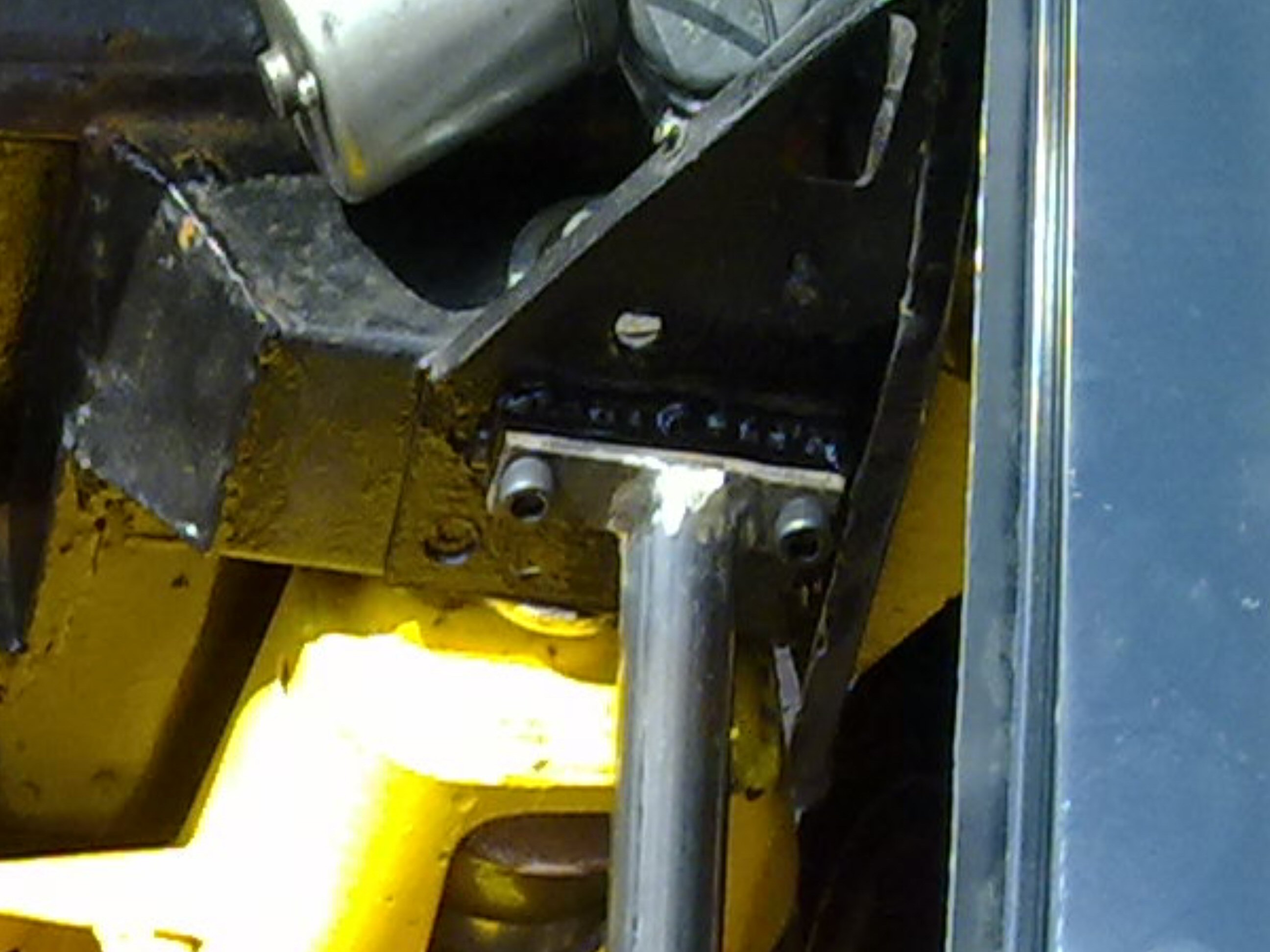

here is a couple of mine, very heavy duty and removable the idea was to tie them into the cage through the bulkhead and hopefully aid in crash protection but i never welded in the full cage and touch wood hope not to crash it

Brett, how did you mount your supports against the tub? I don't see any mount holes or nuts there, and it's a boxed in section with only a through-hole for the tower. Did you cut the section and weld nuts on the back side?

there is a strip of 10mm thick steel welded onto the bulkhead then 10mm thick steel welded onto the top of the support bar
can see bit better in this pic
