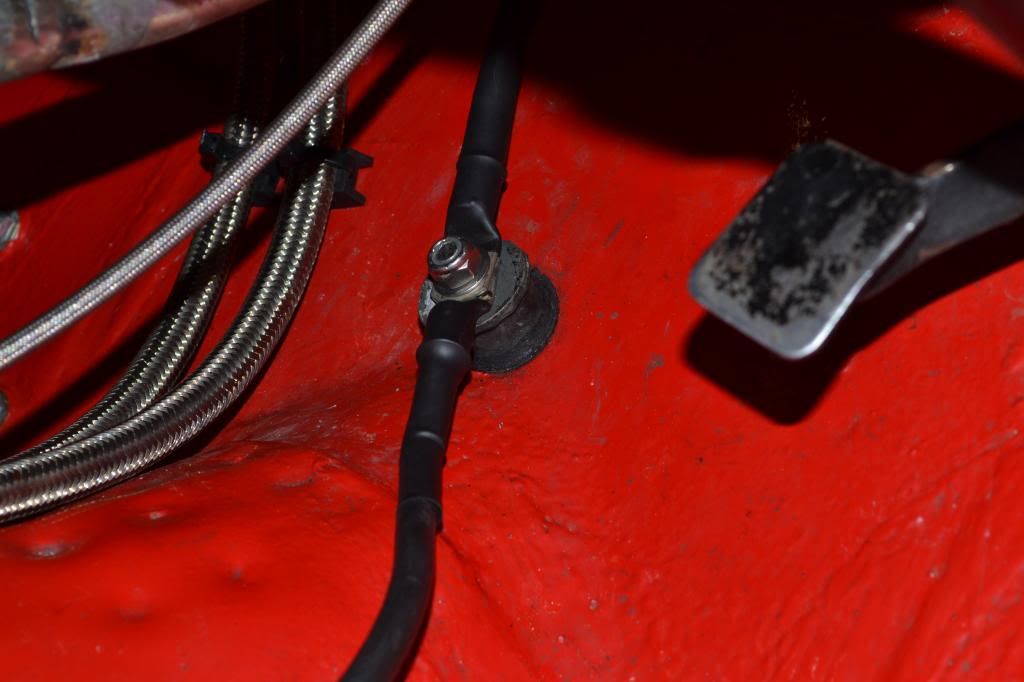

could this be the issue - main +ve cable from battery joined together but bolted to floor - with the meter on the other side I can sometimes with a poke about get 0.1v,

Are you saying that between earth and this terminal you only measure 0.1V? If so, this is your problem as it means they are at the same potential. Either way, an unsheathed connection sat in the footwell is not a good idea.

that maybe your problem

Are those fuel lines aswell?

That is the positive cable from the battery I'm guessing??
Disconnect the connection you have pictured. Bolt the two ends of the cables back together through the lugs but not to the car floor. Insulate it completely... Retry your tests.
The picture shows (to me) that there is some insulating material under the connection, a rubber stop or something but the nylon nut and bolt will create a short. Make sure the connection does not touch the car floor.. Or any other part.

i have seen a lot of kit cars do this with exhaust rubbers using it as a terminal block

Ya I can understand that.. But the rubber is pointless unless you use a non conducting nut & bolt i.e completely nylon... Otherwise you may as well bolt it to the floor without the rubber..
those exhaust rubbers dont have the bolt all the way through, its a bit of rubber with a stud on each end...
if that was grounding the car would have burned out by now.

Ah that would make sense..
