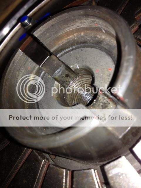

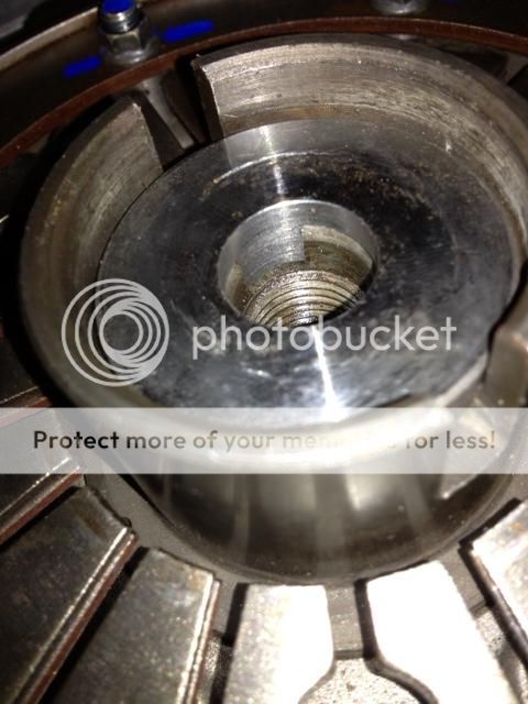

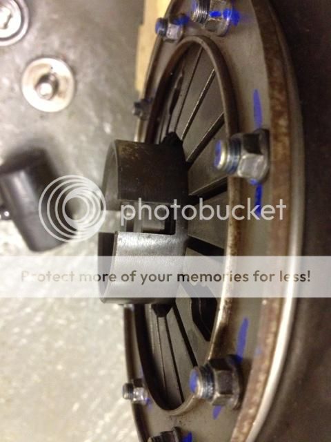

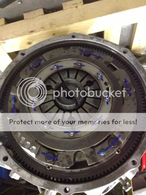

Never fitted a flywheel before. Does this look right. The flywheel sits slightly proud of the end of the crank taper. This causes there to be a small gap behind the keyway. Keyway is engaged in both crank and flywheel
All looks correct, I can't see any other way of it bolting on but I thought I would check with you guys who have done a few of these vertos .

Looks right. You'll probably find that when its torqued up to the almighty strength it needs it will close up if it does need to at all!
yep thats right.
make sure you do it nice and tight, I warm mine up a bit before i whack them on too.
