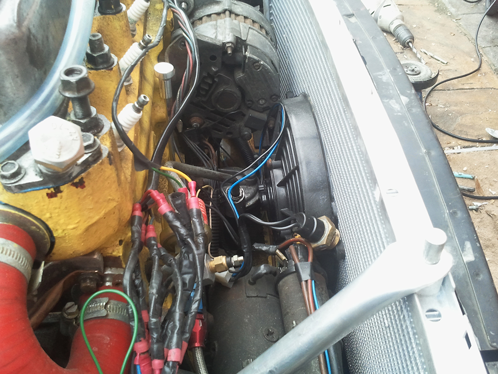

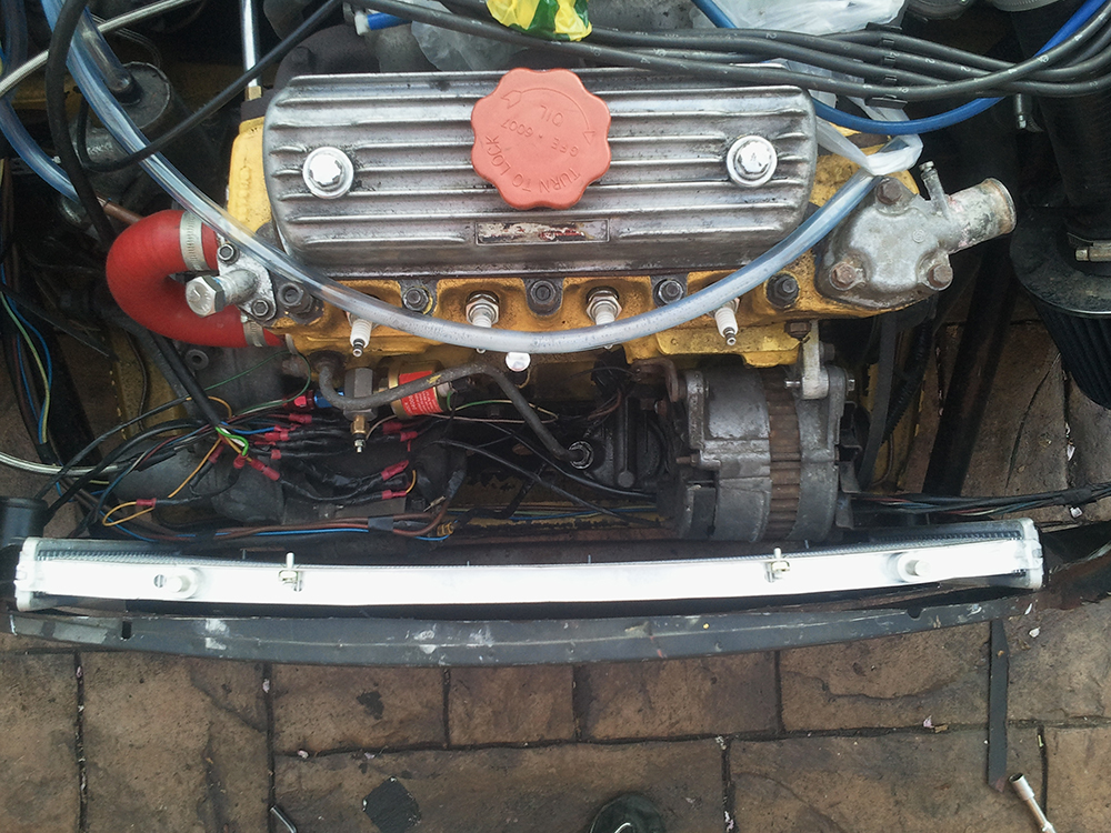

ok cool. seems the fiat ones can bend a bit perfect! :)
you can gain alot of space here is a couple pics
although im on a jap alternator now

Wow, that is not a lot of bend in that, I will get some pics up of mine tomorrow, then you'll what I am talking about

its bent to match the curve of the slam panel its not a competition on who is the biggest bender *wink*

lol, nice one. On a serious note though was not competing, just thought Nick was talking about more of a bend
