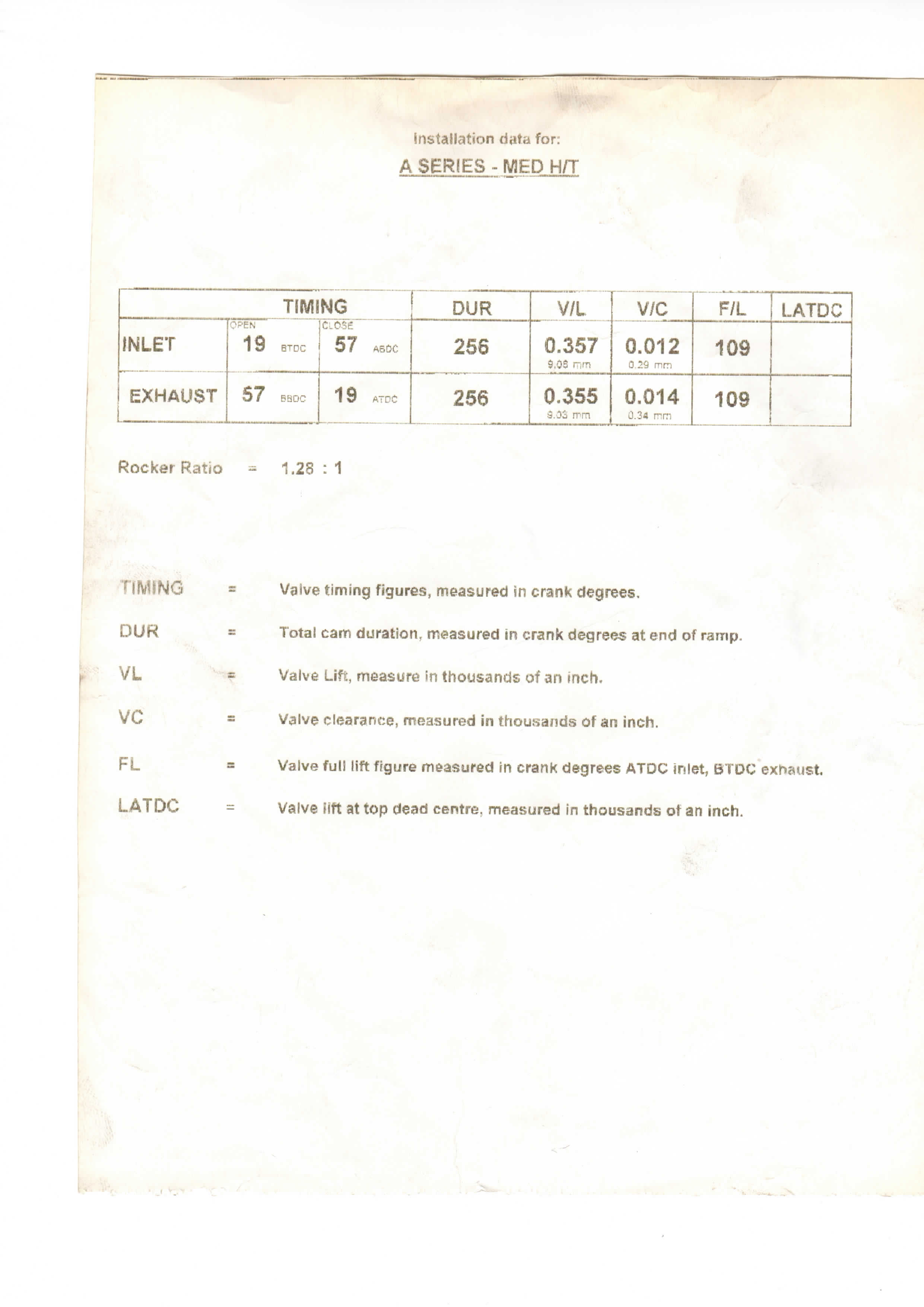

Has anyone done a comparision of these two cams. Both companys dont seem to be very willing to make the data public. Would be very interested to see a comparison on lift, duration etc.

I got this much if anyone is interested
sw5... from ac dodd
Checking height: 0.016" @ lobe
Timing: (Intake): 16/48 (Exhaust): 52/12
Nominal lobe lift: (Intake): 0.281" (Exhaust): 0.281"
Duration (Intake): 244 (Exhaust): 244
Lobe centre angle (Intake): 106 (Exhaust): 110
Lobe separation angle: 108
Lift on overlap: 0.036"
