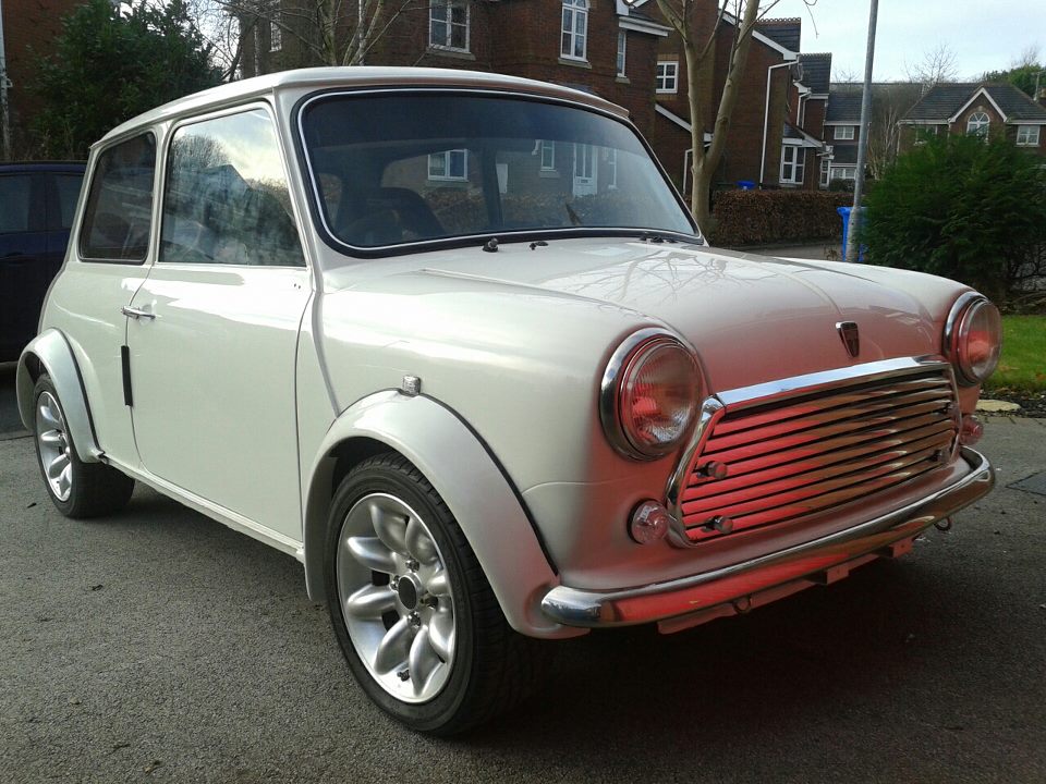

Hi All,
I have a set of 13x6 sportspack wheels under sports pack arches. I've never been happy with the way the rear wheels sit in and don't really fill the rear arches. I have mini fins on the back drums which I believe have a spacer inbuilt.
Has any one addressed this issue before?

I run a 5mm space on my rear with 13" 5.5 wheels. (not sport pack arches). What I founs made the biggest difference was changing the camber on the rear to about -0.5deg. Changed the look loads, although I changed it primarily for handling reasons.

5mm?! That's next to nothing I was thinking 50mm spacer! Obviously I'd have to have longer studs etc.
I'll look into the camber to as I have adjustable brackets on there.

Mine has the built in spacer on the drum plus 5mm and that brings it out so the tyer is just inline with the outer edge of the arch. You will need to gauge what apacer you need depending on the gap you have, obviously, but 50mm seems a lot.

They are supposed to be like that. if you look at a Mini with 'correctly' fitted sportspack arches, the leading and trailing edges at the sill line just cover the tyre, while at the top they flare out. Same on the fronts. This is specifically designed into the car inline with regulation just like any other car. The main reason they are like that is to reduce sparay in wet wether and catch stones.
As others have said the sportspack kit used a 1/4" spacer on the rear, more for clearance issues on the radius arm and inner arch, although, I managed to get away with it on the Yokohama A539s, the A048's rubbed and i then had to use the spacer.
If you don't like the look of the sports pack arches with the sportspack wheels, other than adding 3/8" spacers, there is not a lot you can do, other than maybe buy a 7" wheel with a different offset, but then, it can ruin the handling if the suspension is not set up correctly.
The problem is when the arches are incorrectly fitted, they look terrible.

I'm meaning those whome fit sportspack arches onto a car that did not leave the factory with them.
The arches can be fitted incorrectly. Mainly the rears. Most people fitting these arches will fit the screw on the front leading edge at the sill, too far back. This pushes the arch up and out at the top. The other mistake made is using the freely available template, as I did in 2005. They are just wrong!
Factory cars are likely to be spot on, and you'll notice that the back side of the leading edge at the sill is nearly in line with the radius arm grease nipple. so many are not!
The copy aches will not fit very well in the same holes for a Genuine arch, been there and done that. It's close, but no cigar.
by the way, the rear ride hight on my car needs lowering, the whole suspension has been overhauled, the last job os setting the corner weights *happy* The inner arches have been tubbed and the sportspack arch closing have been cut out, to allow the wheel to go full travel without touching anything. I'll be setting right height for road use, but alter it for track so it sits much lower, almost to the point where the wheels are tucked up into the arches, for that slammed look *tongue*
