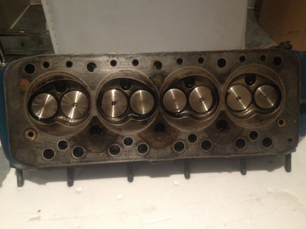

You may want to measure the size of the valves as they definatly looked bigger than yours IMO

Wow forgot key details lol!
35mm inlet
31mm exhaust
Reading up on RTS Clutches
i dont mean to be negative but ..........

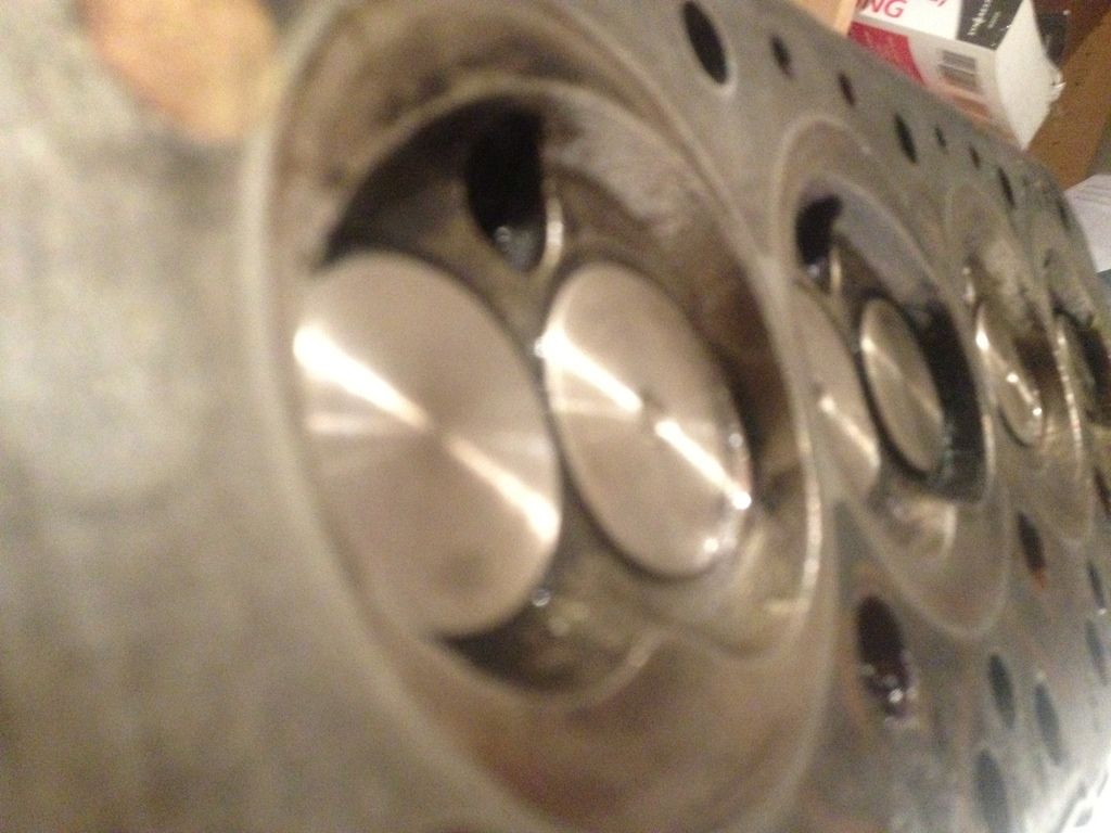

the head looks standard to me 33 mm inlets and 29mm exhaust, both standard valves.
and standard chamber shape none modded not 28 ccs in there .....
have you some pics of those of those enlarged ports ?

just measured them with a ruler and thats what i got
will get pictures up of the ports
there not as crazy as the other guys haha!
remind me how to measure chamber cc's?

Looks like a standard head from the pics to me too.
10022 Posts
Looks like a standard head to me too! If there is 28cc in them chambers they certainly don't look it.

how do you accurately measure CC's though? lol!
the chamber size is from memory
valves through the centre edge to edge
3.5cms & 3.1
thats how you measure them right? :S
carbon through between the valves do make them look abit smaller i guess and im no pap :p
anyone local to me that fancy measuring both for a beer? :)

This is a 28cc head:
The difference in the chamber shape is obvious.
10022 Posts
Get some pictures of the ports up. Pref with a bit of light down them.
You can see the casting marks on the chambers and the shrouding around the valves.

I've had a quick look on the forum but couldn't find a guide so try this;
http://www.circletrack.com/techarticles/ct...es/viewall.html
