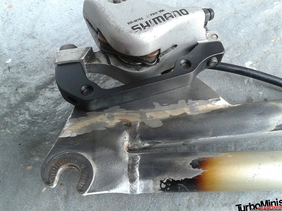

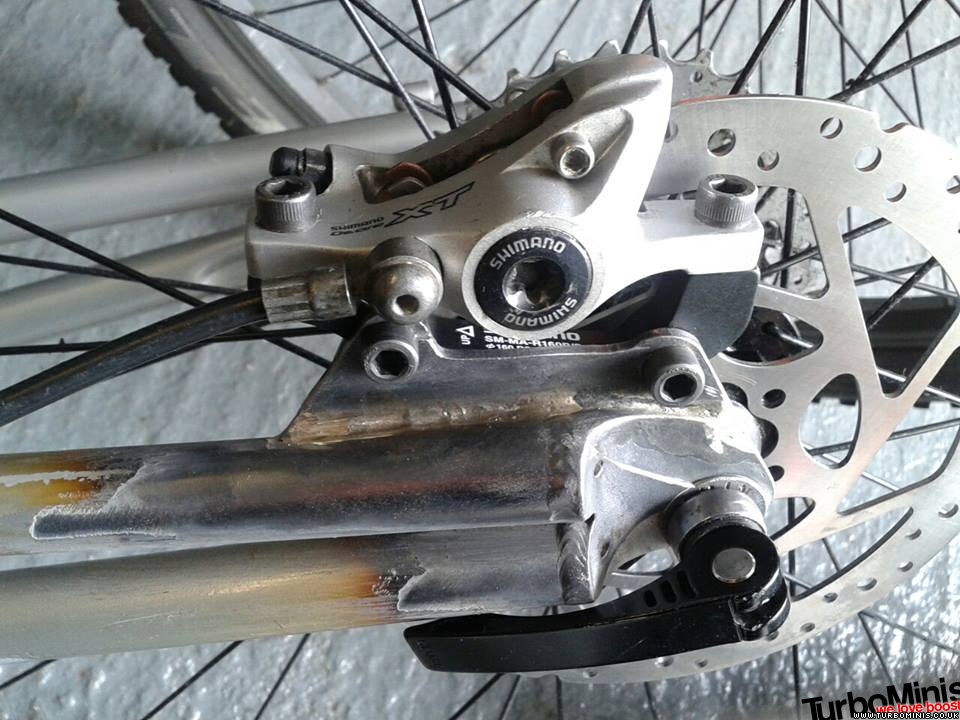

following on, I finally got round to actualy doing this. I made the bracket from 4mm mild and shaped it to fit nicely along the dropout and stay tube then tacked it on with the mig on each corner. I added two more tacks on the inner side and then doube checked the alignment, and adjusted the pitch a little as the tack welds had obviously shunk a little as they cooled (my main concern with welding it). Once I was happy with the alignment, I brazed the bracket onto the the frame along the entire length of the join and built up the shoulder on both sides for added strength. Cleaned everything up with the wire wheel and a quick tidy up with the grinder and I am well pleased with the result. It took me a couple of hours start to finish with all the assembly/ disassemby, fabricating and double checking. Last job was to cut off the V brake posts and grind them fluch with the frame. Spot priming with high build and a flat over for the top coat of paint is the next task.
