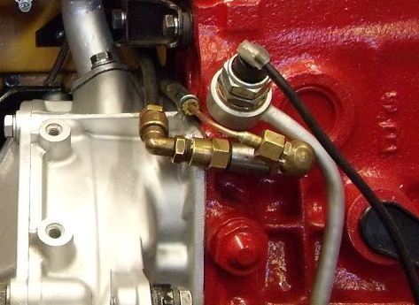

Guys can anyone help.. I'm would like to use my standard Metro T3 Turbo Oil feed pipe, the one with the fixed banjo ends. But I'm totally confused on the bolt fixing arrangement to the block. I can see it goes into the oil presure 1/8 T/Thread drilling, how did they supply the oil feed pipe and use a presure gauge at the same time what kind of bolt did they use and Does anyone have one.. Cheers

I got a specialist bolt to do that job and the thread stripped on me twice. I ended up buying a new feed pipe from mini spares with a banjo one end and female fixing the other end... best off in my mind.
Or drill and tap your block somewhere else for your pressure gauge

Is this any help?.. Alan

I do like that.... Thanks
