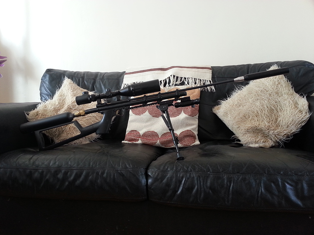

here is my last creation, this is more customised rather than home built, based on a crosman 2050xt

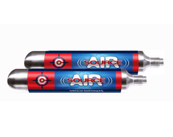

bore is not critical once above 10mm ish but... i think im just going to adapt an 88g co2 cartridge there are good for 1000psi easy i will be running regulated co2 on this i think so likely not to see more than 200psi in operation

it is basically that, much larger valve and a 24 inch barrel all steel and ally, whisper quiet and can group pellets on top of each other @ 25m :) my local range has not long since shut down so dont get to play at longer ranges much anymore
