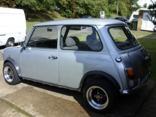

I'm Dave (yes from Essex) and my car Ogy is my first mini.
In the year I've owned him so far he's moved from a rather sad looking sprite to something a bit more... "me"
From this:
To this:
But in the nature of all things mini, the auto gearbox promptly fell apart! Luckily a buddy had a metty engine doing nothing (auto) that I was able to keep going with, but it's only a stand in measure.
