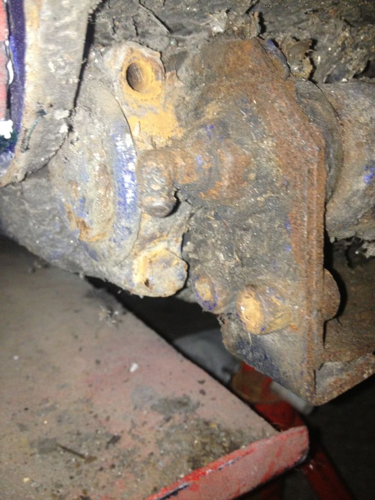

Everything went smoothly, no casualty's
Last two bolts and she's off!
Beer time right?
No :/
Bracket between the radius arm and the subframe is blocking the bottom bolt both sides
So I can't get the socket on or ring spanner
Can get an open ended one on at an angle but dont want to round the bugger
Brackets Attatched by old rusty rounded Allen key bolts too
Ideas?

Drill the allen bolts

Not really enough room for a drill but worth a shot!
Don't particularly want to angle grind it either lol!

blowtorch mate heat them right up should come out easily then

Is that because you have it on a ramp, how about mig a nut onto the bolt head, heat it up and undo?

Should be easy enough to drill those allen heds off, looks like theres loads of room.
Your going to have to remove those allen head bolts anyway otherwise the trunnion bolt won't come out.

its on axle stands atm
drill wont handle it :(
mig is in the post so i guess its..
ANGLE GRINDING TIMMEEE *happy*
once the subs off and everything is out of the way i can get the stud out no probs :)

Open spanner from underneeth takes a while but comes out, did this on mine took about 15mins

But would have hit the allen-bolt head before it came off
Cut it off and managed to get the rest of the studs out when the subframe was dropped :)
