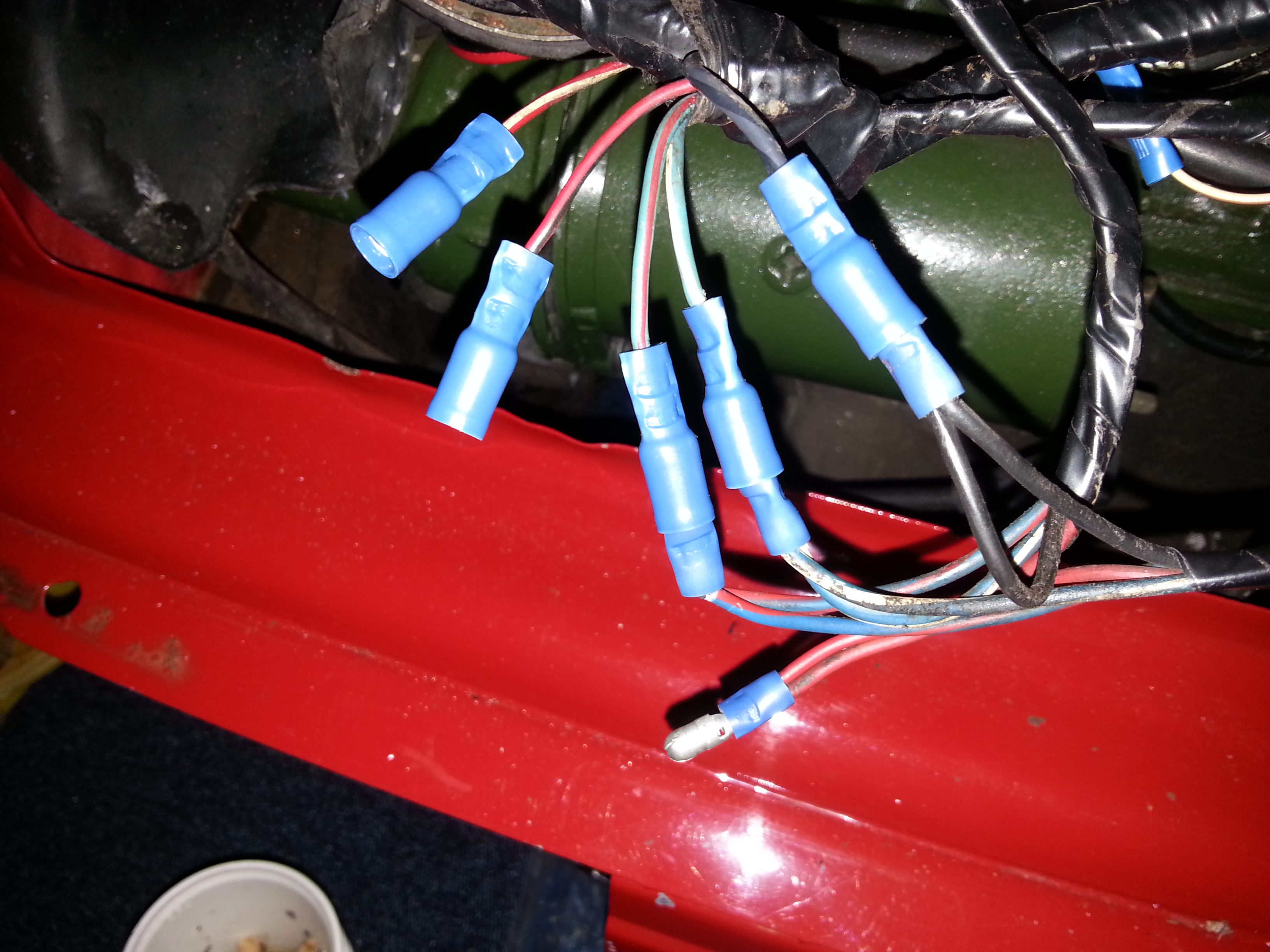

I'm having some problems with the wiring on my K reg 1993 .
This picture shows you the problem I'm having. I dont see any green and red
Wire to connect the 2 red wires to and cant remember how they were wired in before.
And im not all that good with wiring.
Thanks.

Later cars used different colours to earlier ones.
Red/white - RH side lights
Red/black - LH side lights
Blue/red - dipped beam
Blue/white - main beam
From what I can see in the photo, this seems to be what you have.
Hope this helps.
