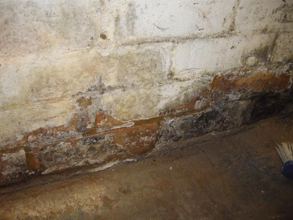

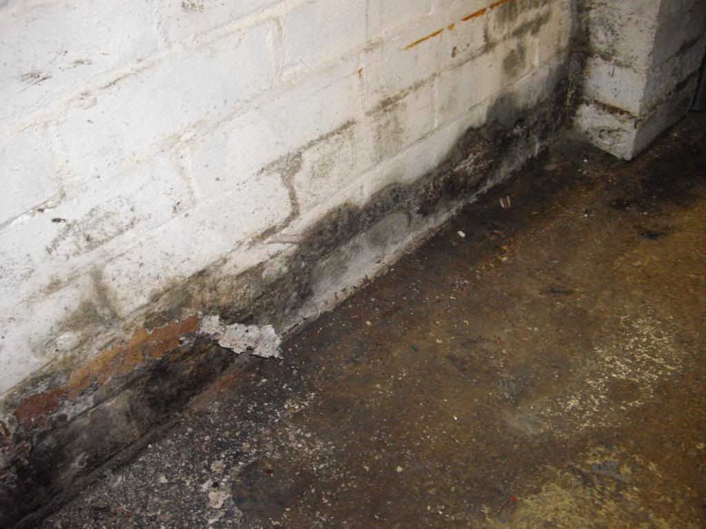

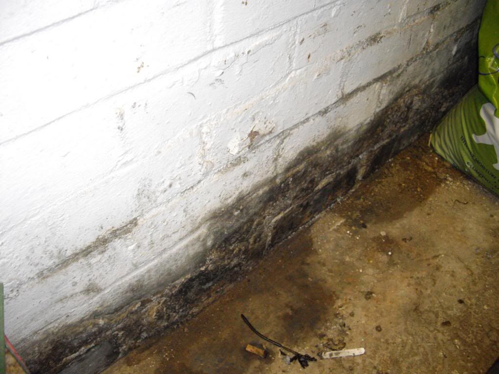

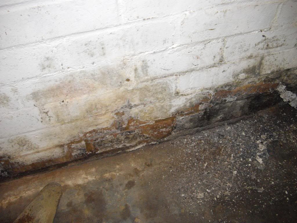

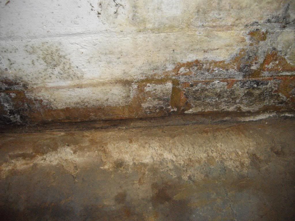

Ive had an issue with damp staining the paint on the bottom of my garage walls (inside), so since Im doing a garage refurbishment at the moment I thought Id strip back the paint, water down some PVA and coat the areas before repainting,
While stripping back the paint I realised the mortar and even the foundation/floor is a bit soft so decided to work out why its damp.
It turns out that the tarmac of the public footpath on the other side of the brick wall is higher than the lowest brick of the garage therefore letting in the damp and causing what Im concerned to be a possible future structural problem.
What do you guys think?

I would attack the outside, there is plaster That are waterproof you could also use à special foundation paint or good Old tar

Paul, do you know if the bricks are engineering bricks or commons?
paul i have seen this many times, what you need to do is make a 4" wide channel along that wall ouside the garage remove the tarmack and soil to a depth of a nats below the floor in the garage job done.
if its prone to gather water there place some of those arco water channel ducts to duct the water away.
or get the gibbbons at the counsil involved but you may be waiting many. years *frown*
Commons mate

I personally would dig at the pathway myself, but making sure its neat etc so no one will know or complain, i cant see the counsil doing alot, but like said previously ir want to be dug below your lowest course and find the most apropriate way to get rid of the water. At the mill at work its prone to flooding and we used a silicone based paint on silution to seal the walls in case the worst happens.

in that case, the only proper way to deal with it is to the remove the source of moisture externally, as all the others have suggested. remove the paving and permanently reduce levels or expose to apply a waterproof render below ground before reinstating the path.
there are ways of dealing with it internally with a tanking system but my concern, as yours is, is that the bricks and mortar will continue to deteriorate behind this.

as said above it needs a drain of some sort to remove the water and also needs to be sealed below the floor height with a membrane from the outside
i dont know how things work with your local peps but if someone reported me digging outside my property they'd slap a big fine so be careful
