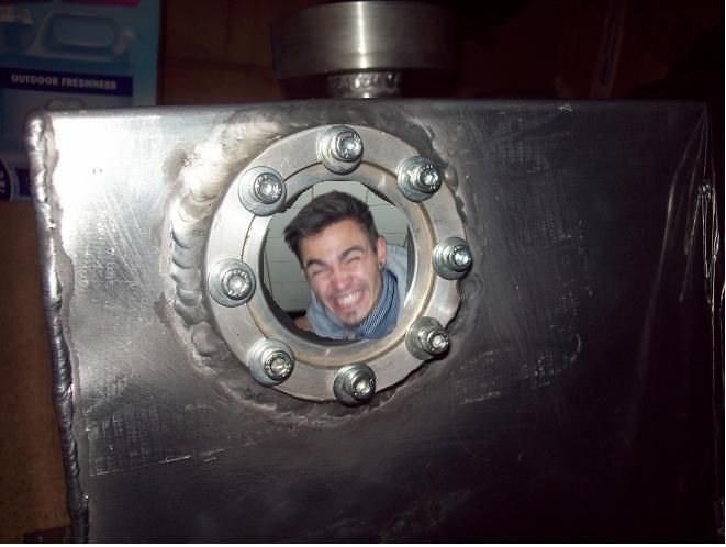

I have this tank from John, think he got it from MarkGTT who said it needed a universal sender, but looking at it I cant find one thats even close, most have a much smaller pcd and 5/6 bolts which go through the gasket-just a hunch but looking at that recess, I would say it takes a solid mini type sender with the rubber seal behind and the bolts and washers clamp it down but I dont have one to try, any ideas maybe even from the man himself?

A mini sender is 62mm diameter. I need to swap the one in my tank for a non injection one if you want one to borrow.

Cheers bud, the inner recess is around 63mm so thats looking favorite, I will hang a bit see if someone confirms it, but if its right and you have one spare I will buy it off ya, can throw it in with the large pile of

Yeah it takes a mini sender, but I don't think I ever fitted one.

Magic-Cheers for that Mark, at least I know what to work with now

Just been prating about with my sender. I have the early smiths clocks and the injection sender is poop with them. Tried a used one for a 5 gallon tank and that works OKish, but only gets to around 3/4 - 7/8 full. Going to order a new sender and bend it to match the injection one.
You can have either of mine Oli if they suit your needs.
P.S. Didn't notice Mike taking a dump in your tank lol.
