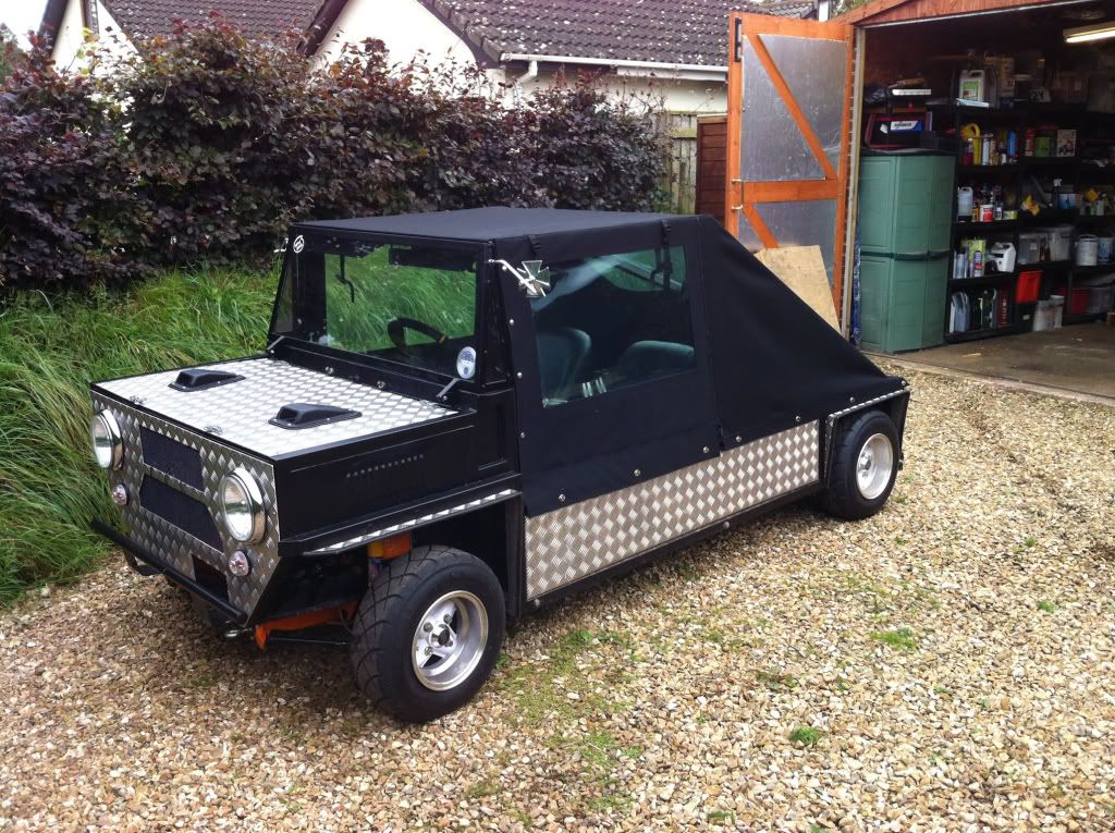

Its a 1293 with omega pistons 11cc dish a benross head with enlarged valves etc , straight cut drop gears and 4 pin diff , turbo is standard t3 but rebuilt by turbo techinics . If I want more BHP I will change the turbo but being that its in a car that weighs under 500kg I don't need the extra power just yet :)
The main thing is its a strong motor and capable of a lot more should I want to upgrade it.

Thats an achevement then if its under 500kg's

Under 500kg fair play! I ran a T3 at 18psi and achieved a fair amount of torque! You should be able to run more boost based on that cr but you will probably find the car way more driveable at 10psi
this is in the scamp isnt it? i bet fun is an understatement lol
Yeah that's right , its just bonkers *happy*, best way to describe it is like having a go kart on the road !

Excuse,y ignorance ihavent ever paid any notice to them Do they corner well and use the normal mini suspension?
They are Mini based to a point, basically its a poor mans Moke. The suspension is mini but it has no rear subframe with the radius arms attaching directly to the main body.
