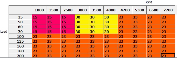

I'm just having a go on the megajolt software but am a little unsure about the last bit, here's a screenshot
Thanks for the help
Paul
On 17th Mar, 2013 Joe C said:
you want 15 deg at tick over ( LH columns upto 1000-1500)
leave 100kpa up as 23
the block 3000-4000 up to 70kpa make 30 deg then taper it in to th above two.
try somthing like this
as an example here is my map, note its the other way up as its from megasquirt, but the general idea is the same
