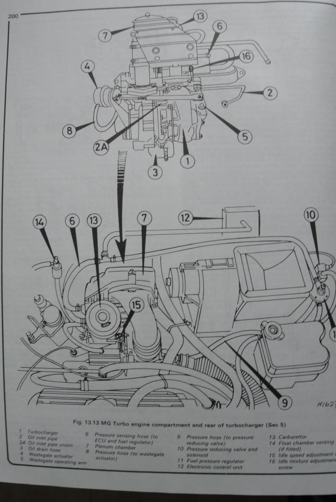

If the valve has an 8mm tail to connect to then it is the float chamber vent as I said. Anti run on valve is larger.
nala56
825 Posts
Member #: 9661
Sheffield South Yorkshire GB.
Hope this helps guys.. Alan
Main Build
Upgrade to Turbo
metroturbo
806 Posts
Member #: 989
North Yorkshire
The turbo vent valve and MG anti run on valve look nothing like each other. I'll bet my cock that that is an MG Metro anti run on valve.

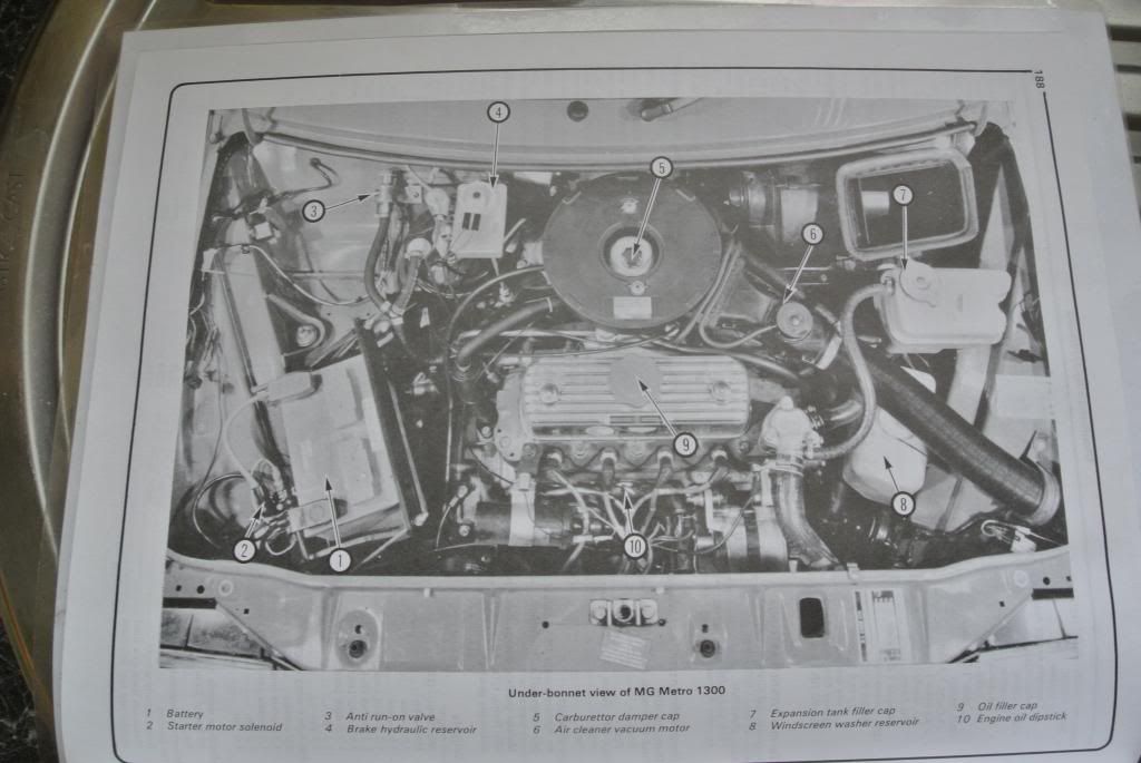

Found some more information, which confirms both opinions to be correct in there own right, if you know what i mean.. Alan

ok so am i just to block it off on the plenum chamber where it shows 6???
No. 6 is the feed to the regulator to tell it to raise the fuel pressure!
metroturbo
806 Posts
Member #: 989
North Yorkshire
Number 14 is the vent valve, and it connects to the carb.
