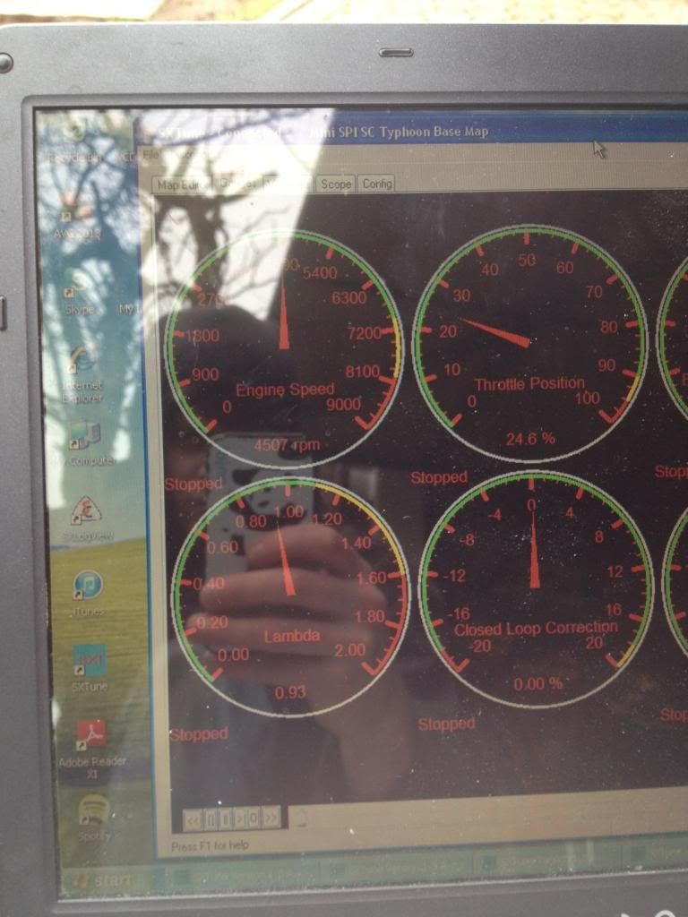

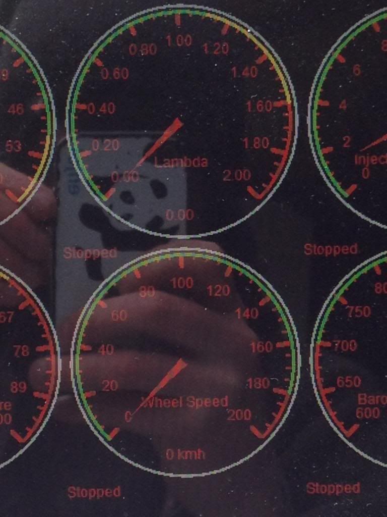

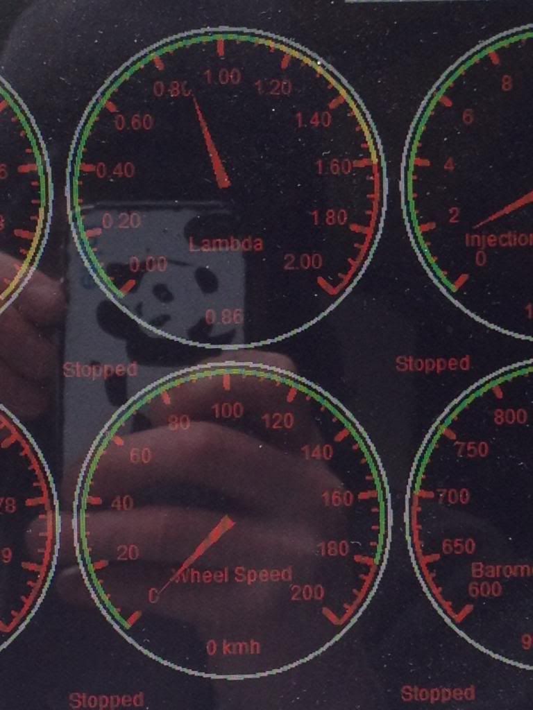

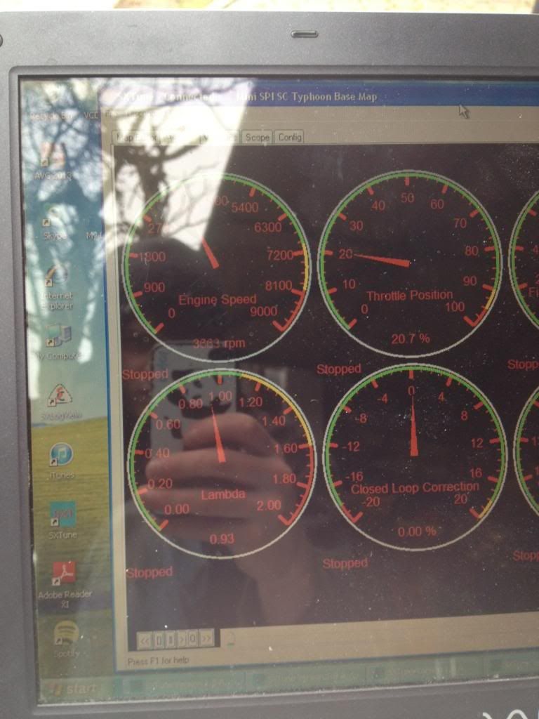

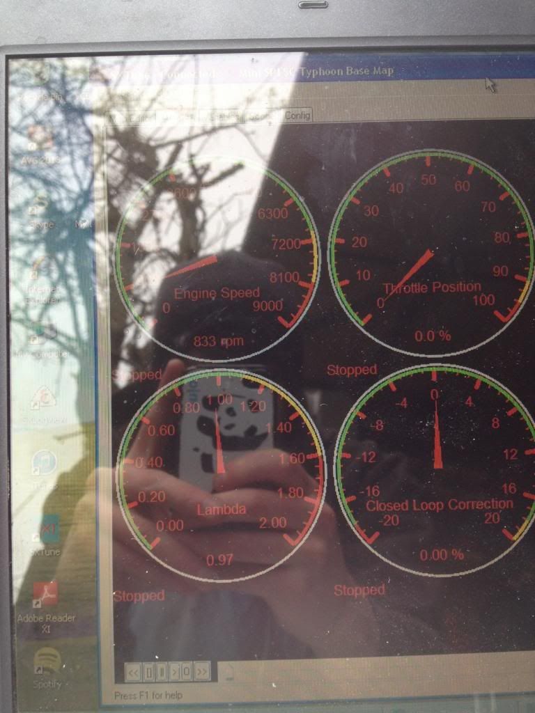

Here are some shots that i took of my ecu readout a while ago, i think the ones where the lamda was reading 0.97 constant was when the car was cold (is this normal) some reason one of them shows the lambda reading of 0 as well:S
i did also check the lambda sensor using a multi meter which fluctuated from about 200mV to about 500Mv was a while since i checked this

Too much going on here.
When I talk about diagnostic readings I'm talking about the standard ECU.
If you have stalling problems with the Specialist Components ECU, then I suggest you talk to Simon and John at Specialist Components. It's not that I can't help, it's just that it could become a conflict of interest.
If on the other hand you put the standard ECU back in, and provide the diagnostic information I ask for, I can start to point you in a direction that might help you solve your problem.
Please tell me though, does the Specialist Components ECU still use the stepper motor function? as that alone without proper tuning of the system can lead to stalling issues on overrun. It's not that it doesn't work, it just works in a different way to the standard ECU.
Any help with the Specialist components ECU will need comprehensive data logging while the event happens, a few pictures of the computer screen just wont cut it. This will be what Simon or John will also ask for. Logging is the key thing with any sort of programmable ECU. It allows you to sit down and analyze the mass of information presented at any one point in time.
