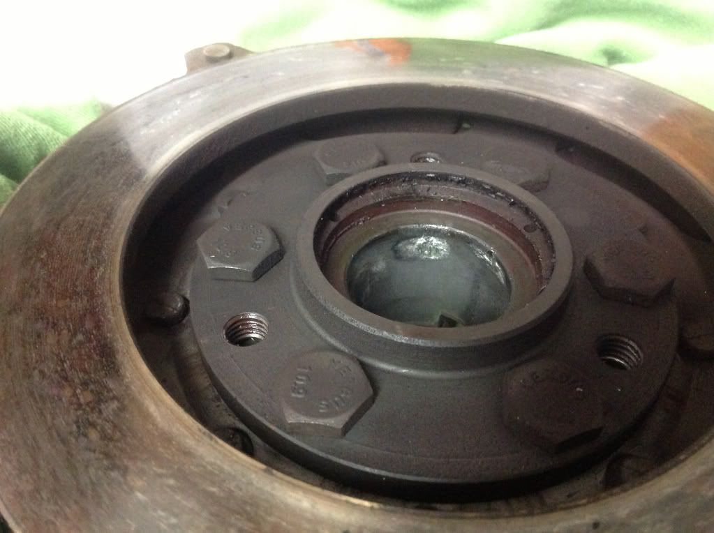

Checked out the crank when I got home tonight and the rest of the taper is fine. Below is a photo of the flywheel hub. The silver bit you can see on the inside is the crank shavings that have built up over time.
I believe I can clean it up and re fit it. In fact I'll more than likely do this anyway.
You may want to replace that hub, as it doesn't too good from the pics.
I managed to recover my taper like yours but slightly worse, by taking the high spots off with a diamond file, then using fine grinding paste took the final high spots off.
If you put grinding paste along the whole taper you'll find the widest part of the taper will lap in before the narrower sections as the surfaces are travelling a further distance with each rotation. So make sure you only lap them together until the high spots have gone.

Member #: 10315
Thanks Matty.
Will try and clean it while keeping it as even as possible
