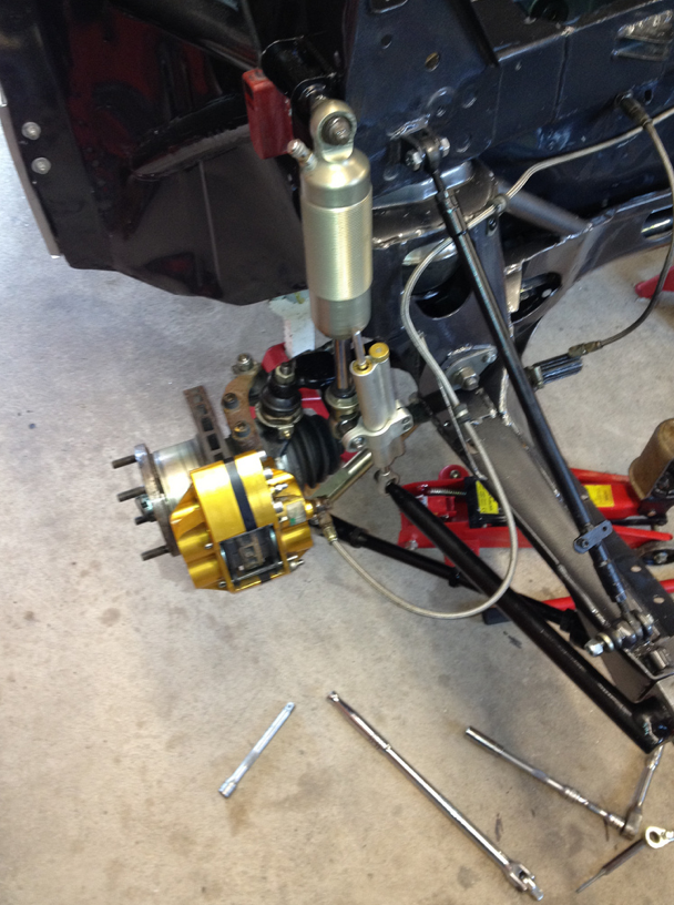

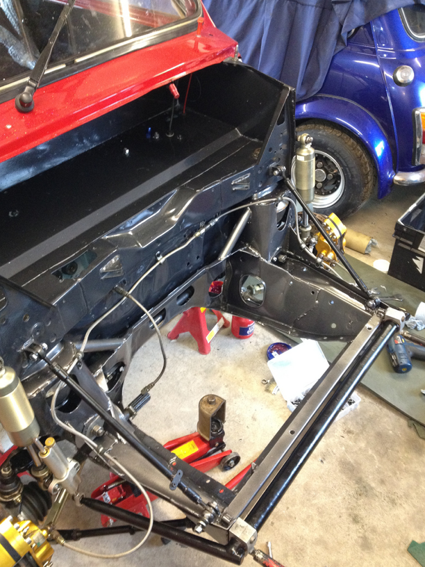

This is what it looks like at the moment
I have mounted a 1242FIRE from a punto 75 with mikuni carbs. This is just my spare engine as I am building a new engine :) And I have proper numbers at the side now
