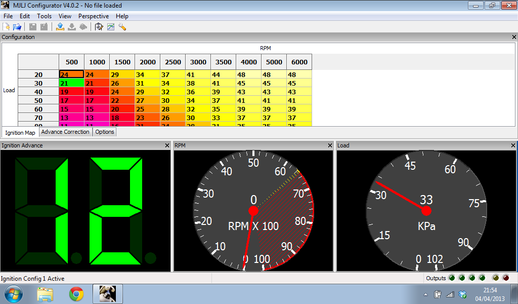

converted MJ from tps to map as instructions on autolabs website.
reflashed with V4.0.2 firmware and all good, but when connect on the bench and com port set up the load gauge reads 33 kpa *surprised* shouldnt this be around the 100 kpa mark. tried to blow and suck on the pipe but no movement.
i only removed the R3 resister off the tps section as per the forum. should i remove the rest.
any ideas guys
i would start by removing the parts not needed ( 3 i think) it sounds like something could be holding the signal low and another common error is soldering the map sensor upside down

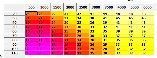

this is the map im thinking of running to get me to RR, whats your thoughts.
mini was on dizzy running 16 degree at tick over to 32 degree advance, would you also leave the 12 degree advance at starting or adjust

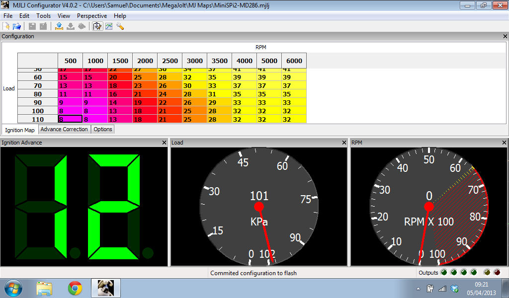

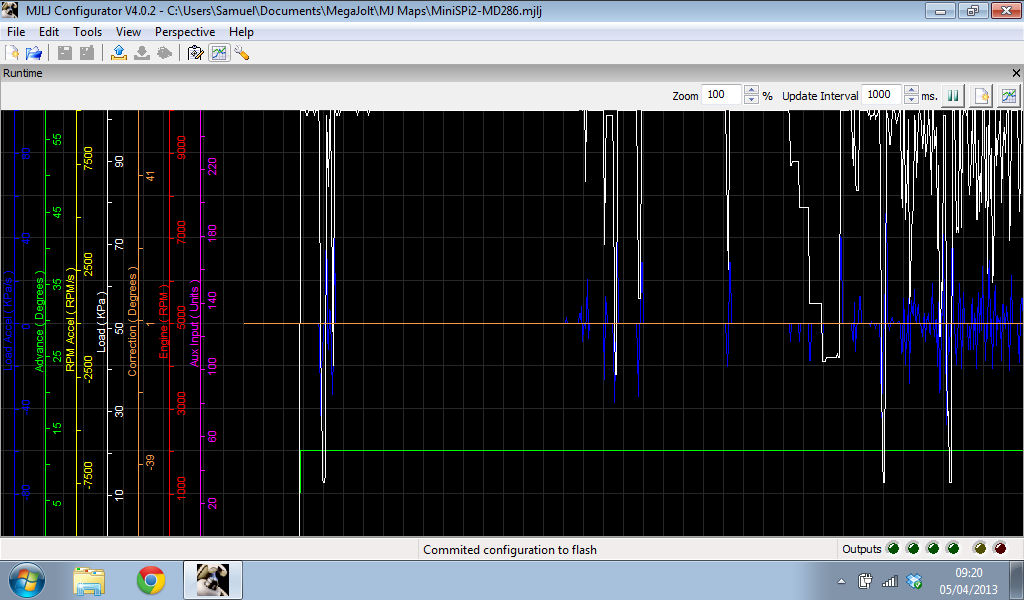

cheers brett, de soldered map and put in right way this morning *smiley*
the little lad has even been playing as you can see from the logs.
