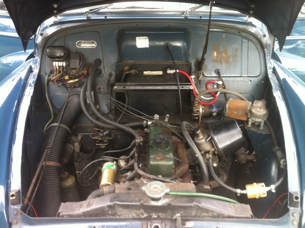

Hi, thinking about turning my morris into an a-series turbo.
Going to be a rolling project, need to get engine up and running with all cooling ect mocked up ready to pull 1098 out and turbo lump in over a weekend as need the car to get to work
I have read through a few threads on here but have a few questions...
1) As minors are rwd, what block would be best, 1275 midget or an 'A+' from a 1300 marina/ital?
2) Do I need a metro turbo head, or will the standard midget/a+ head be ok? Or can the non turbo heads be modded to suit?
3) Want to use type 9 box for the 5th gear, plus std box probably not handle extra power,what clutch would fit + be upto the extra power?
4) I know I need the metro turbo, manifold, actuator ect but what about pistons? Only wanting a standard engine, run 4 psi boost (no ecu) but heard you can fit a solenoid to be able to switch between 4 and 7 psi boost?
Can anyone think of anything different needed for a rwd engine or anything I can do to make all this easier with the added space in engine bay compared to minis? (Photo of bay attached)
Just want a rough guide so I can start collecting parts
Cheers, James.

On 6th Apr, 2013 BENROSS said:
lets wait and see, i would not advise anyone under 30 with more than 80 hp i have been there with my son sadley!
[color=red]Not enough, all answers are hidden somewhere[/color]
[color=red]no block is better than another, all are suitable assuming suitable condition[/color]
[color=red]Nope, any 1275 head will do as a starting point, contact Bennross or Turbo Phil for advice on what they can do for you (in exchange for money)[/color]
[color=red]no idea, as suggested others have done similar search out their build threads[/color]
[color=red]lots of pistons are suitable for low boost setups, a quick search should link you to ones currently available[/color]

You need a 7.5 inch clutch with a modified flywheel.Peter May Engineering sell the kit but ittis not cheap.I have some used stuff lying around,pm me if I can help.Also think about the rear axle partic half shafts.If only for street use,may be ok,but look at better shafts.
'Where does the engine go?'
tadge44
3006 Posts
Member #: 2500
Buckinghamshire
And the standard gearbox wont last very long.
Fitting a type 9 is an answer, but it will cost quite a bit.
A Sierra 1.6 clutch can be used on a modified flywheel and has held 140 bhp on my car OK
