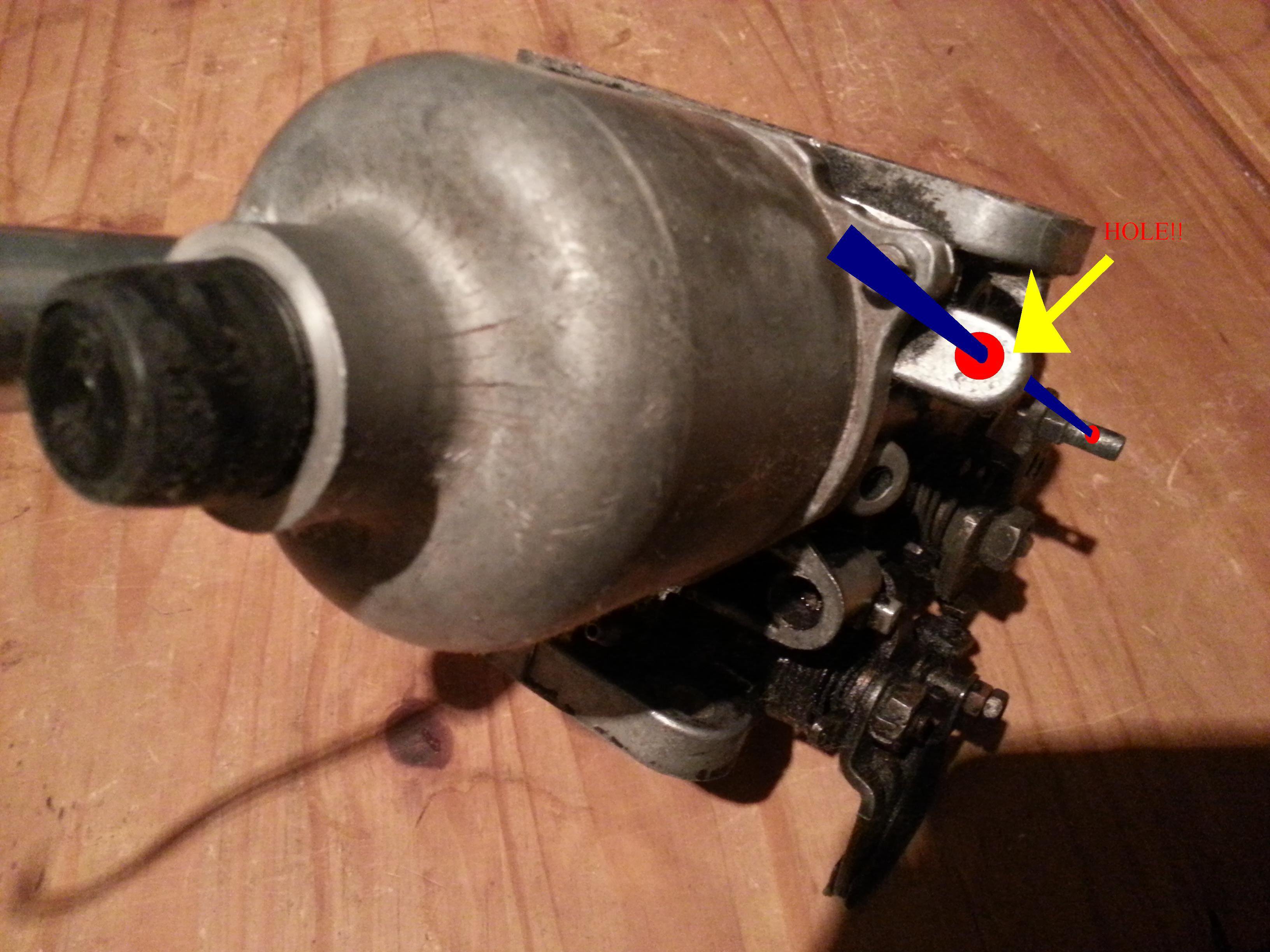

would you believe it every single photo i have of the carb the pipe work blocks the view so i wll use pics of another carb i have
right this is the best i can do without digging my mini out :(
the hole i have pointed to you want to drill all the way through the lug with a 2 mm drill bit then drill through that with a 6mm drill bit BUT only go 80% the way through, so what your left with is a good sized recess to locate the choke cable and hold it in place

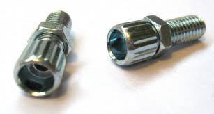

something i bought but never actually fitted is the little screw adjuster off a bike brake lever shown pic 3

right i have got 3 pics to work
1st pic you can just see the hole in my carb

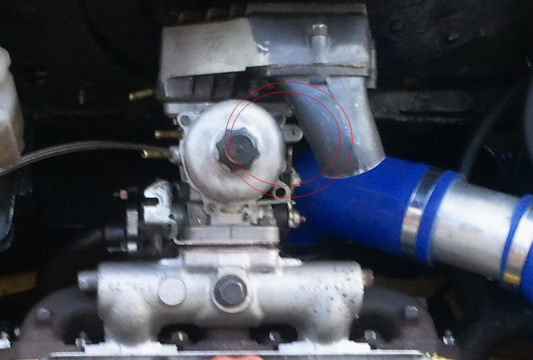

2nd roughly where the choke cable goes
3rd a nice neat solution and quick adjustment

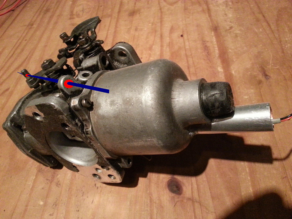

4th same as one ( and took 7 edits *angry* )

That's as clear as it can be Brett ! I've got it mate thanks for the messing about *happy* seems pretty straight forward ,those little clamp things in pic 3 look good ! Thanks again mate *smiley*
