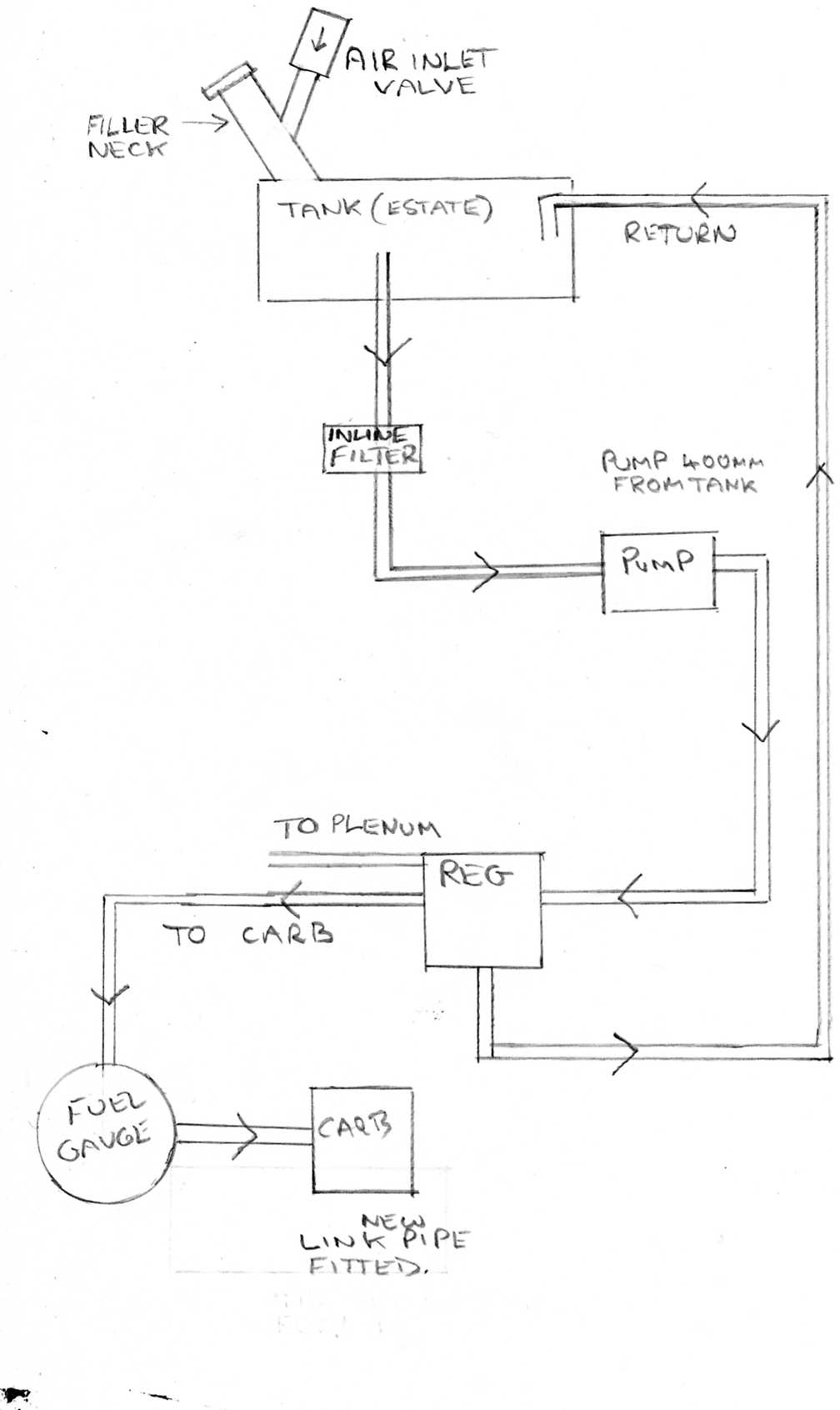

Draw a schematic of exactly how you have everything plumbed up etc. It will make it far easier to diagnose.

This is my plumbing drawing as requested .

Is this a new problem or a new build? Has this fuelling setup previously worked OK or have you recently changed it all and it never worked right?
Just one little point maybe worth considering - in your sketch it says Estate tank.....
They seem to have reputation of problems because they are so shallow so the pump easily loses suction.
Have you been testing with it fairly full or fairly empty ???
I don't like the idea of the fuel filter before the pump, unless it is a specific filter for fitting in the suction of the pump.
filters in the suction of pumps are usually more of a strainer to catch the big crud that could easily damage the pump and have a relatively low pressure drop across them. The filter would normally go after the pump and before the carb or fuel rail.
The main reason for this is that a filter has a reasonibly large pressure drop across it even when new. This will cause the pump suction to drop into a vacuum. some pumps just don't like running with a negative pressure suction.
Compound that with some shit in the filter and the greater the problem.
Also, on the estate tank you have no head of fuel, as the outlet is piped to near the top on the front side of the tank. Thus the pump has to pull it from the tank. Compared to a saloon tank where the outlet is at the bottom so you get a gravitational head of fuel to the pump inlet.

Have you tried it without the pressure gauge in line? And make sure the filter is the correct way round, and as Sprocket says it would be better off after the pump.

gonna try with out the filter in then,anythings worth a go.
