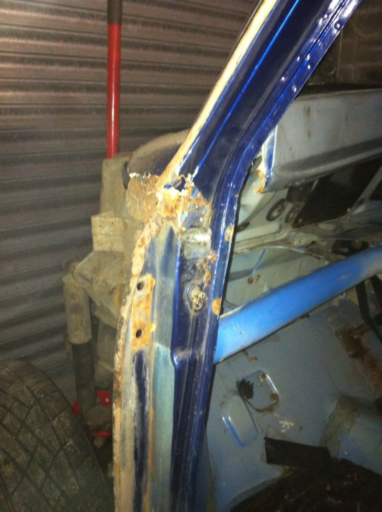

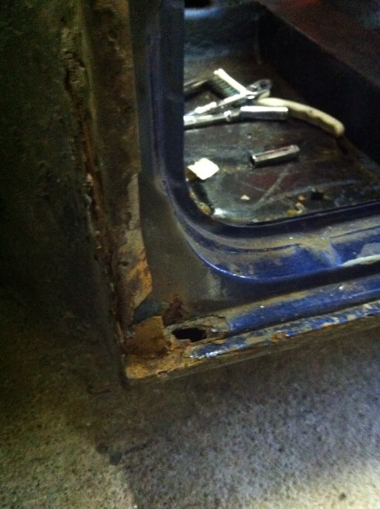

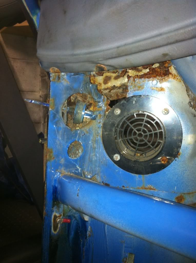

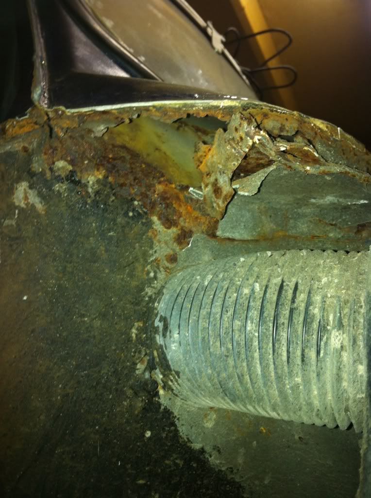

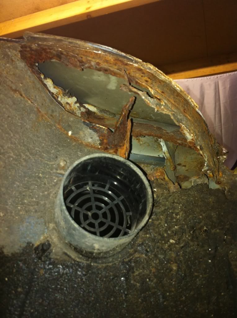

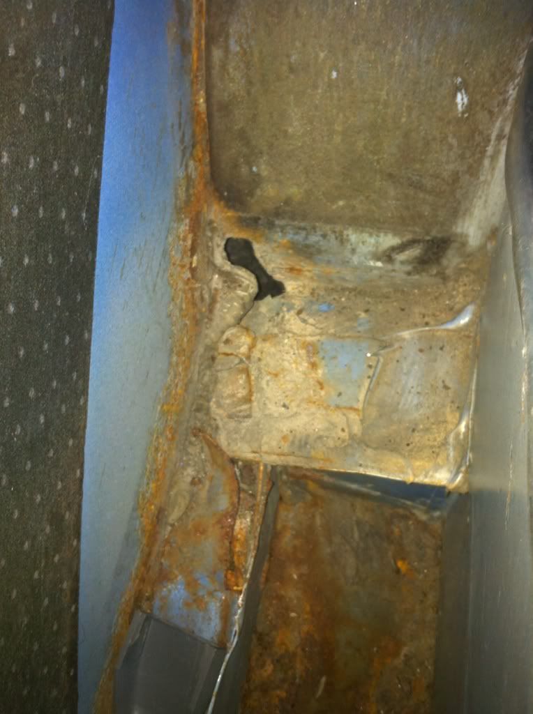

Ive taken some pics of bits that need repairing but im unsure of which panels cover where. I know im gonna need a n/s rear quater panel, theres rust under the scuttle panels but looks like its the edges. Heres some pics.

Passenger sill ?
Drivers side corner scuttle
Passenger under top dash rail
Passenger scuttle corner

Pictures 1 & 3 you want a heritage full sill step panel. They come from the base of the screen all the way round to the B post.
Picture 2 you want an arch closing panel and a small repair to the arch. It will be tricky to fit with the quarter fitted.
Pic's 4 & 6 you need the scuttle closing panels
Pic 1 & 5 you also need the passenger side hinge repair panel with a big chunk of inner wing on it.
Then some home made repair panels for the inner wing tops etc
Agree with Andy. Also, what are the sills like? It looks like they have been renewed before and it would be interesting to know if they are oversills.
You say the rear quarter needs done; is the repair required low level? I could be temped to use an extended step sill repair and a separate panel for the A post

I'd also be tempted to fit scuttle end panels if the middle section is okay. IT will give you something decent to weld the wings to.

I've fitted the scuttle end repairs in the past but in honesty, they are a pain to get a decent fit. Cash being no object, i'd fit the heritage full width scuttle

I wouldn't buy cheapest possible, see what you can get away with pattern, and buy genuine where you can, especially a scuttle panel if you decide to change it. Genuine metal is thicker and better quality from what I've gathered.
I'd recomend the full genuine scuttle,
