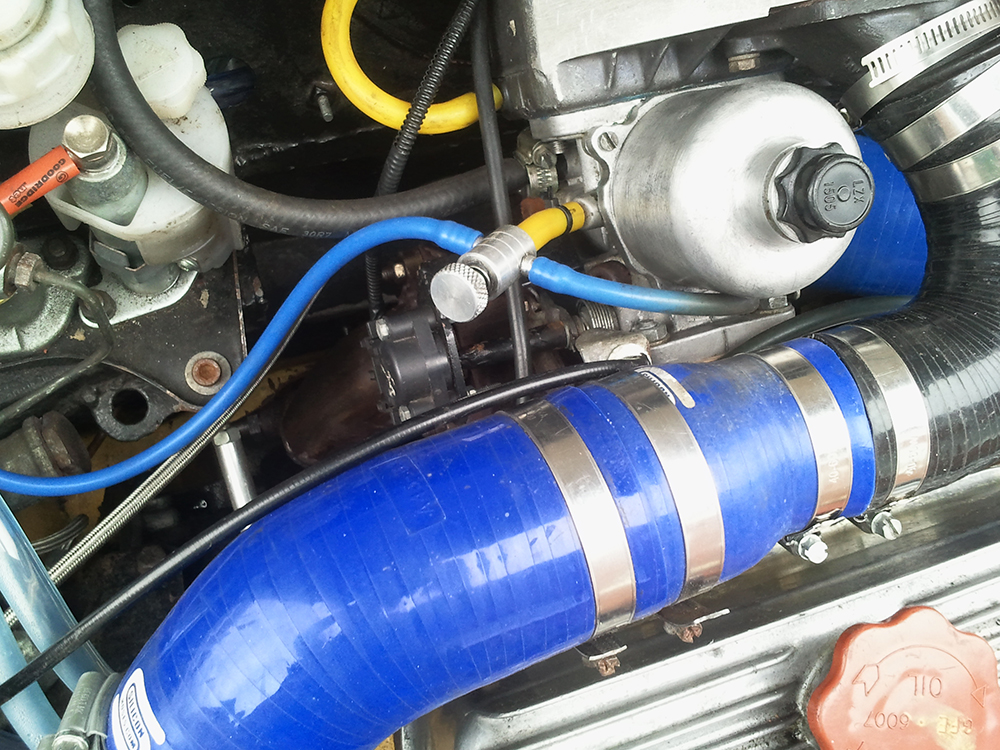

bleed valve between the inlet manifold and the float bowl
my first test was a bit of crushed brake pipe inside a short length of silicone tube
my second was literally a bleed valve see pic
my current settup is a ball valve fitted under my wiper/lights stalk for quick adjustment the rest is ecu controlled similar to an idle valve
my current settup can also 'add' fuel
EDIT: mine however is an N/A carb yours may be different see my next post *happy*

if you want it switchable ( i think robert uses a solenoid) then this needs to be between the inlet manifold and the float bowl
and if you already have the lean off pipe 'nipple' on the top front of the carb thats already restricted and the bleed valve is not strictly needed
the solenoid would need to go in the normal lean off pipe
Mine has a solenoid in the lean off pipe which stays open until the MJ switches it closed.
It works pretty well but I'd like it leaner. Needs more fiddling.

drill out the nipple top front on the carb, either make the hole ever so slightly larger or drill it through with about 4mm drill and use a bleed valve
i love it because i can fuel 12afr in the same needle position as 18afr at part throttle
Ah. That's the trick. I'll try that when its next off. Cheers Brett

thats the one, is it settup without the lean off pipe connected?
if it is currently blocked off just re plumb it with the valve settup how you suggested and watch the afrs dont go too lean

Brett where does the blue pipe on the otherside of the bleed valve go ?
pressure gauge so i could watch what the float bowl pressure was doing

If doing this you need something adjustable, my first attempt used a solenoid and switch, opening it made it run massivly lean off the gauge and it missfired and stuttered, then changed to a bleed valve which I could have half open and it was spot on.
