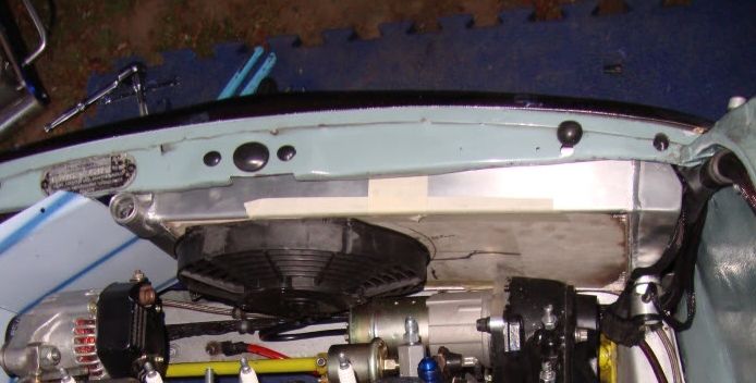

Hi Nick,
I will reply to your Pm on this page as it may of be some help to someone.
First of all, my rad is a one off and I am using an electric pump, if you did not know already, but some of what I put here might help you.
I started with the good old CAD (cardboard-aided design) and made some discs the size of the fans, so I could work out what size I needed.
Next was the fan. I looked at what felt like every fan website on the net, until I found the best and thinest one I could. Also I went for the smallest starter as Every Little Helps!
As you may make out in the pic a good 1/4 of the back of the fan is cut off, so it fits nice, down the back of the radiator.
As for what it is like. Well I have wired it to a light on the dash just to keep an eye on whats going on. It's never on when I am on the move, around town it comes on and keeps the engine at a good temperature. I have never had it overheat so far.
I hope this is of some help simon.
