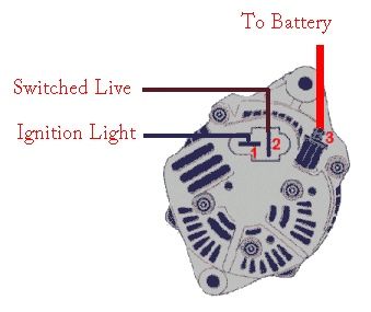

It charges fine, how has everyone wired theres? Any pictures?
There is 3 pins one is not needed one is swiched live and is for the light.
Off the top of my head the middle one is the live one.

Then the bottom for the light and the bolt for the browns (charge)

Right im defantly wired right so il get this diode sorted and try that
