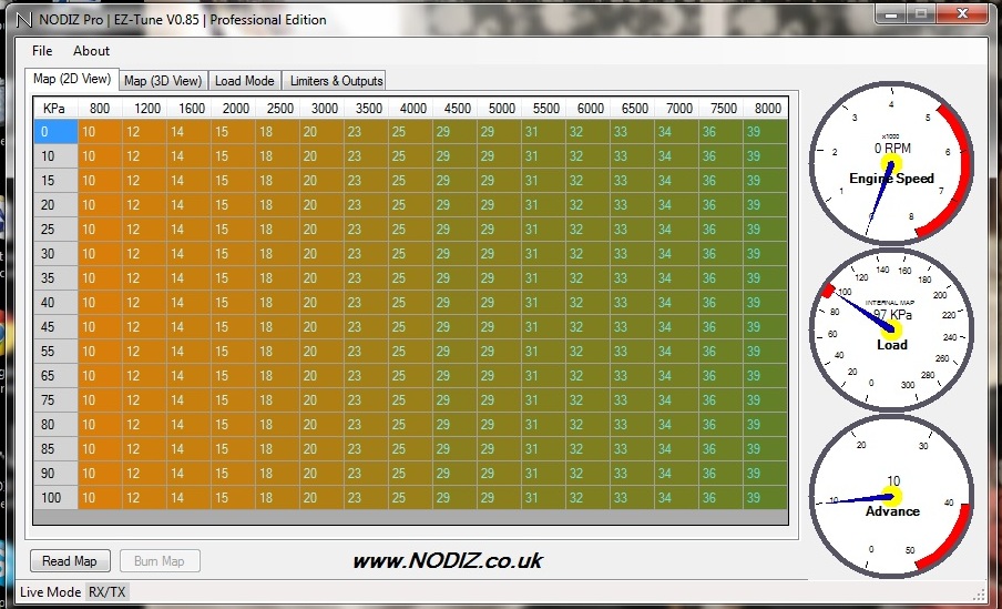

This is a nodiz map, I wanted something nice and easy going, to run on low boost for running in. Ive looked at some MJ maps and they all look as if there values are more advanced, does anyone have a nodiz standard metro turbo map, or sugestions.... thanks
You seem to have no area above 100kPa, so no area of boost on the map.

Help...... can I increase the Kpa .. im a newbie... do you have anything thats basic ..thanks for the info..I take it the kpa is the load on the engine..

So would you say that this for a normally aspriated mini..cheers
aprox 100kpa is atmospheric pressure, bellow this number is vacuum/ above this is boost 200kpa is aprox 1 bar or about 14.7 psi
if i was you i would search on this forum, there are a good number of maps either use one but go steady untill you get it mapped properly
or take note of the shape and numbers build your own then go get it mapped properly
a map like the one you posted will likely cause big problems with any real amount of boost

Ok cheers does anyone have any maps for something low boost..1380cc MG metro N/A Cam ...any help appreciate
Here is a very old map I have for a high boost engine.
Depending on your CR, limiting the advance to 25 above 100kPa is the safets option.
