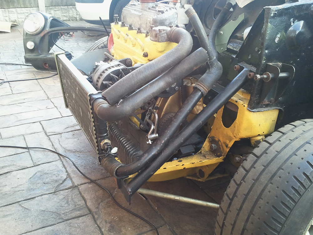

not very good pics.... but should give an idea......
I used the metro thermostat housing, a pre 1984 metro top hose, mini bottom hose, and the rest is cheap silicon 90deg bends and ally tube.... I tigged a small T into the bottom ally tube, which runs up to the (cinq) header tank.
