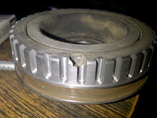

Hi guys,
After following your advice I decided to machine my own pulley, so found a machine shop that could do it for sensible money but this happened *angry*
There was a small drill hole from balancing on the pulley do you guys think its usable? Does it need balancing? It's been centered and cut with precision.
Thanks John
Edited by giannoutsos on 28th Jun, 2013.
nala56
825 Posts
Member #: 9661
Sheffield South Yorkshire GB.
I would say yes

giannoutsos
166 Posts
Member #: 8952
Athens Greece
Thanks for the answer nala test fitted the sensor and should work ok.
