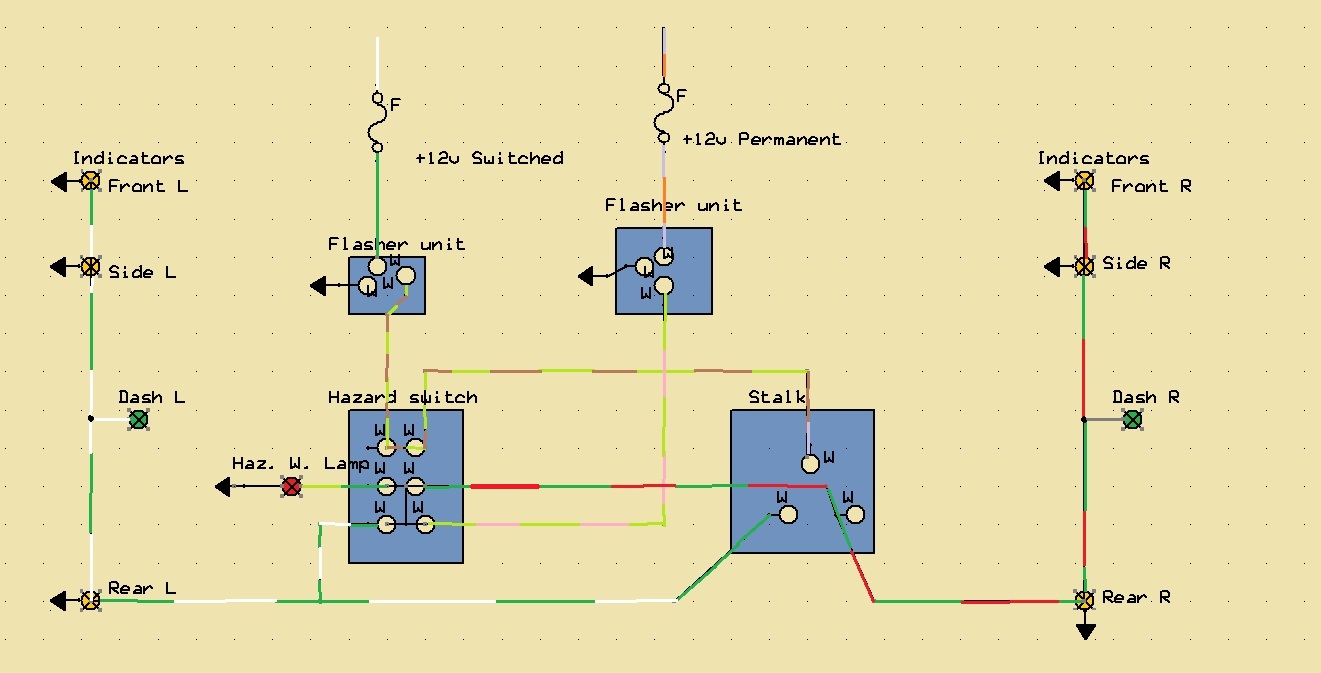

Hi, has anyone got any drawing of how they have wired there lights, its my last major job before a hopeful mot. Im not 100% sure what needs a relay and what can be direct fuded etc, and the indicators... Well i have no clue, so need something to study or some advice.

I think I have a drawing at home, when I get back I'll upload it if I get chance bud.
Full wiring diagrams in my build thread

Indicator circuit

Brilliant... Ill get on it now. Mot in a couple weeks :/
