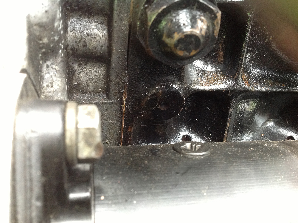

Ok, this is a metro turbo block. I am working on getting it run NA with the MJ. It turns over fine, but I have this pool of oil under the car. I traced it ack to a small hole behind the starter. It in the middle of a round pad, below the oil pressure valve. Is this normal or something someone tried to do and I will need to plug. I'm thinking I will have to pull the starter. Drill out farther, tap and put a plug in. |
4th May, 2013 at 04:56:00pm
that should be pluged, its the gallery to let any oul that gets behind the il relif valve drain to the sump On 28th Aug, 2011 Kean said:
4th May, 2013 at 06:20:04pm
A simple pop rivet will fix that On 26th Oct, 2004 TurboDave16v said:
Yep I agree with TD........ |
104 Posts Member #: 8965 Advanced Member MIldenhall, Suffolk |
4th May, 2013 at 06:25:53pm
Thanks. Will pull the starter and do that. |
