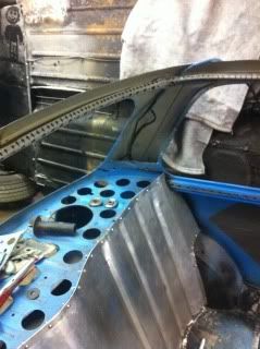

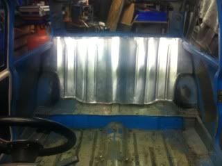

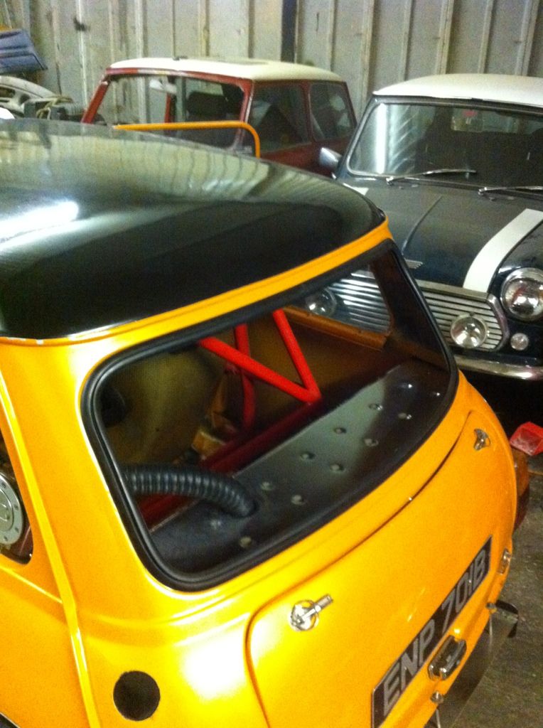

Here is a few pictures of mine I left the parcel shelf In and have a titanium tube between the rear turrets
Andy
