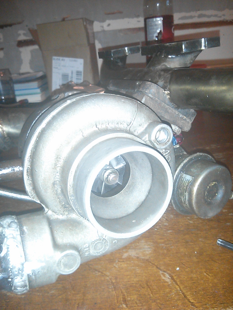

My t2 turbo doesn't have a connection on it to take the pipe from the actuator. The hole that these normally go to is not there but there is a hole at the top right of the picture with a little Allen bolt in it.(I've removed the bolt in this picture) Can I put the connection in this hole?

Just take the signal from the plenum.
The metro Van's GT17 had the same thing. Thread was 1/8 BSP so took a standard barbed fitting. I expect this will be the same.

Cheers, can't believe I didn't think of that. Over thinking stuff again
